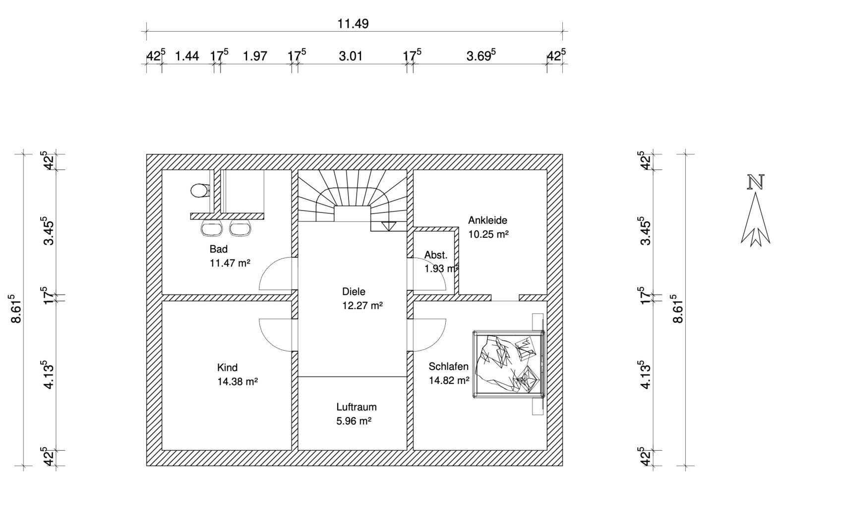

we are now almost at the end of our planning process – the only thing we’re not completely satisfied with is the staircase. :-)
According to our architect, another staircase design isn’t feasible due to the dimensions – but I’m not ready to accept that yet, so I’m trying my luck here 🙂
We would prefer a U-shaped staircase with one or more intermediate landings – that would really be our dream.
So my question to you all – do you see any possibilities that I/we might have missed?

... if you change the staircase, a completely different floor plan is needed. The house would have to be deeper, larger, or include a staircase bay window... usually, you tell your architect in advance what you want 😉

A staircase with a landing requires more space, which I do not see in the floor plan.

A different staircase means a different layout of the rooms upstairs as well as downstairs.

Different staircase = different floor plan. I agree with the previous speakers.
