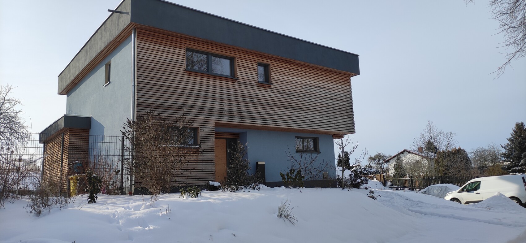

Sebastian Acht14 Apr 2021 00:36Hi, I have been living in a straw bale house myself for four years. I designed this house together with my wife and built it within a year with the help of two friends (excluding windows, flat roof, water and wastewater systems, and electrical installations). Issues like mold, mice, or other pests, as well as fire safety, are absolutely not a concern in a straw bale house. Our house achieves an efficiency rating equivalent to KfW 40+, and apart from a water-bearing wood stove, there is no other heating system installed throughout the building. Heating costs amount to around 250 to a maximum of 300 € per year. From mid-March, the stove remains unused about 80% of the time and is only fired up again around mid to late October. During this period, we burn approximately 3.5–4 m³ (124–141 cubic feet) of beech wood to heat the house and 1000 liters (264 gallons) of water in the buffer tank. In the remaining months, we heat the water exclusively with photovoltaic electricity. Inside, the house is plastered with clay and lime plaster. On the outside, the straw bales are covered with 6 cm (2.4 inches) thick wood fiberboards and 2.5 cm (1 inch) of lime plaster or larch cladding. The indoor air quality and living environment in a straw bale house are almost unparalleled and far superior to prefabricated houses or those built with conventional materials. It does not smell like straw or anything else, provided it is properly constructed and moisture cannot penetrate the straw. However, the same moisture risk exists with insulation made of mineral wool. The construction costs for our house were approximately 1200 €/m² (111 $/ft²), including 1600 m² (0.4 acres) of land. The FASBA is already a great resource to obtain a lot of information. Additionally, there is a wonderful DVD available online called Stroh im Kopf.
