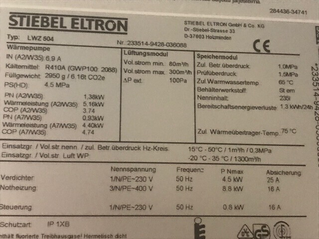

I have been looking into our new unit quite thoroughly for a while and can’t shake the feeling that the air source heat pump might be undersized for our house. If I understand correctly, there are two different power versions of this pump, A2 and A7 (is that right?); we have the A2 with 5.16 kW.
However, the user manual says this pump is designed for an output up to 10 kW.
Since we have a relatively high electricity consumption, about 30 kWh daily for the heat pump (3 people), I checked the KfW documents. Here, a heating load of 9 kW including hot water was calculated.
The explanation of the heating system also states that we have a system with 9.3 kW capacity.
Could this be related to the seasonal performance factor or annual performance factor being included in that calculation?

I’m a bit confused – am I misunderstanding something? Does the pump below actually cover the demand? At night it’s always louder than usual, and the electricity meter runs quickly...

boxandroof22 Nov 2019 08:02ENGCHRIS schrieb:
A2 and A7 (is that correct?), we have the A2 with 5.16kW The A stands for the outdoor temperature, the W for the supply temperature, and the sticker shows the power output and demand under these conditions. The capacity will be sufficient. It is important to maintain continuous heating, ideally without thermostats. Search online for thermal/hydraulic balancing and heating curve with low supply temperature. Once you have this set up over the winter, the system will operate significantly more efficiently than if you leave everything as is. You can disregard the Energy Saving Ordinance and KfW specifications when sizing the heating system. For example, the ventilation system is often overlooked there. We had 7kW indicated, calculated 4kW for the heating, and in reality it is less than 3kW.Thank you very much for your responses; that already puts our minds at ease.
