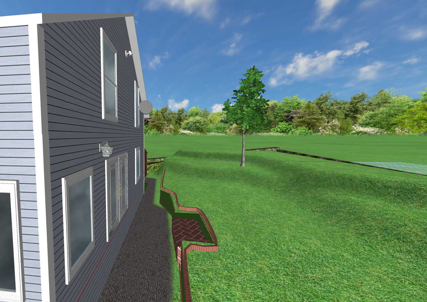

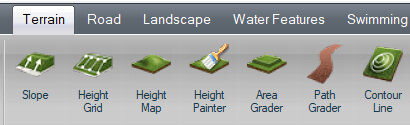

With "Realtime Landscaping Architect," I’ve gotten to the point where I can create "curved" gardens (with small steps and hills) using the "Terrain" feature.

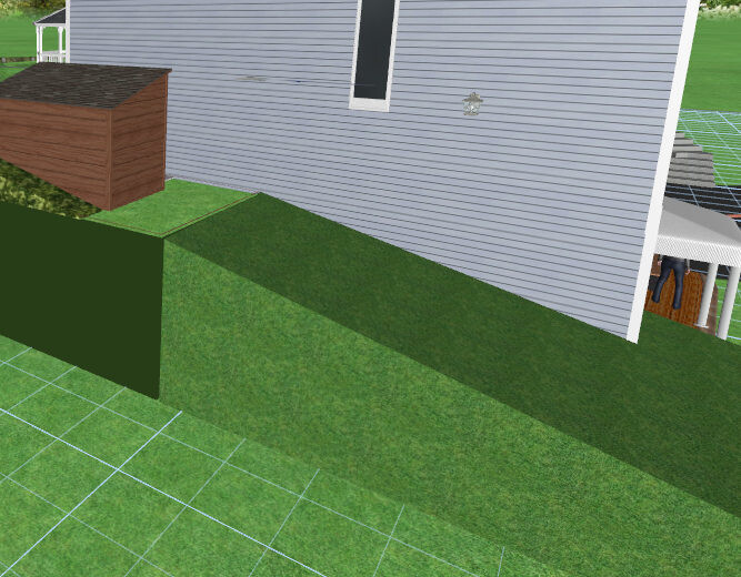

For a slope along the house, I “repurpose” the "Wedge" function found under "Modeling":
I assign the "Wedge" a "grass" texture, which results in a straight but inclined lawn area (slope).
Sloping grassy hill next to a gray house with a window; wooden shed on the left.
Screenshot of the terrain toolbar showing slope and height functions in landscaping software.
Exterior view of a blue house with garden, green lawn, and tree in the yard.
