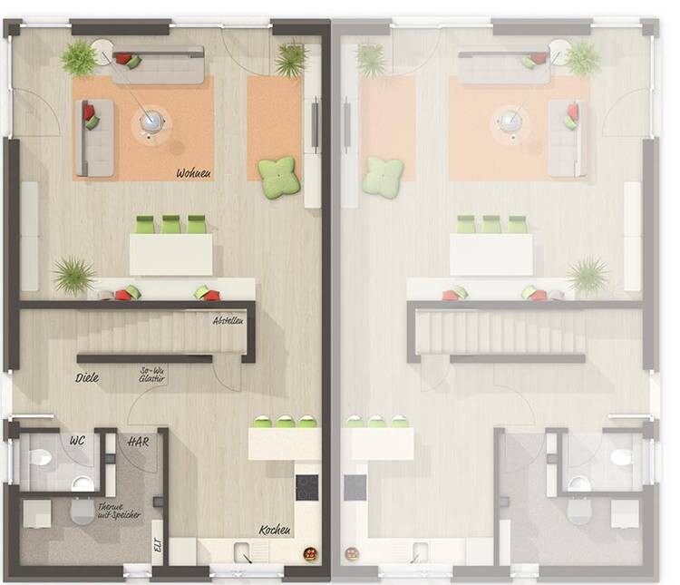

we have been offered a plot of land measuring 10x60m (33x197 ft) for a semi-detached house. The other half will be built by friends of ours who have similar requirements.
Now we are considering how this could fit our needs.
We are now looking for a floor plan that includes space for a bedroom on the ground floor—12sqm (130 sq ft) should be sufficient. If possible, I would then place the utility room under the roof. The rest of the attic space would be used for storage.
So far, I haven’t been able to find any floor plans online that include an additional room on the ground floor.
Do you have any pictures or links for me?
At some point, the children will likely move out, and we will need less space. It would be nice if it were possible to separate a self-contained apartment. This should probably be considered now so that the later effort is not too great...
I look forward to many ideas and pictures.
Simon

The Town & Country City 136 is a semi-detached house with a footprint just slightly larger than your size (7.12 x 12.24 meters (23.4 x 40.2 feet)).
If you move the utility room (HAR) upstairs, omit the guest toilet, and possibly reduce the kitchen size, there is enough space for a bedroom in the utility room area that would otherwise be planned for that purpose. A guest toilet might be possible under the staircase—try searching Pinterest for “staircase toilet.”
However, if you want to create a separate apartment on the upper floor, you would need about 63 m² (678 sq ft) of floor space—which still subtracts around 3 m² (32 sq ft) for the entrance hallway—and also include a bathroom on the ground floor. That becomes extremely tight, and honestly, I can’t really imagine it working. Two rooms, kitchen, and bathroom within 60 m² (646 sq ft)… you don’t really need a whole house for that, so it’s better to skip the idea of a separate apartment!

It is what it is: whether 10x6 or 12x7 meters (33x20 or 39x23 ft)... it won’t be a villa or a bungalow with four bedrooms. It’s a semi-detached house.
From your words “we’d actually like,” I hear sighs.
Get real, focus on 6x10 or 7x12 meters (20x33 or 23x39 ft), and realize that a ground floor bedroom is pointless.
You can barely fit a utility room of 6m² (65 sq ft), stairs 5m² (54 sq ft), hallway 6m² (65 sq ft), kitchen 13m² (140 sq ft), living/dining 35m² (375 sq ft), and a shower toilet 5m² (54 sq ft).
These are sizes for five people that don’t feel cramped, even once the kids have moved out. For three people, a smaller living and dining area will do.
Everything else is a lifelong compromise. If the house ends up too big, you can always downsize later to a smaller place without stairs.
