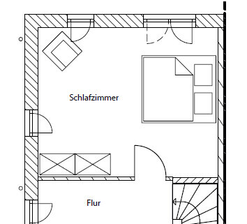

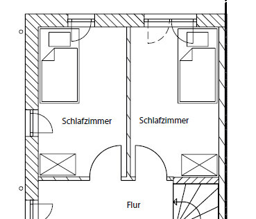

Attached is a picture of the option.
Option without extra wall:
Option with extra wall:
hampshire1 Dec 2020 19:48The question is whether you then need to install drywall and flooring, and if the flooring cost will be deducted for you. If not, you will need to include the flooring cost yourself.
