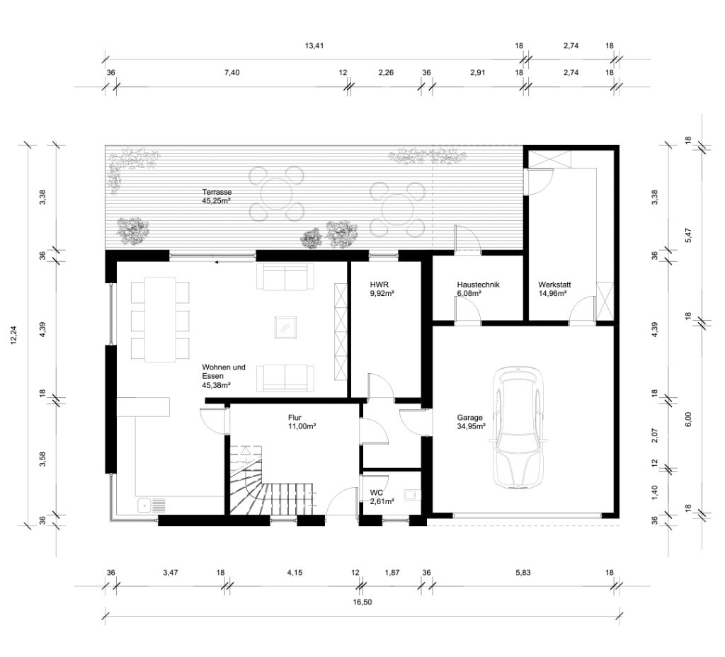

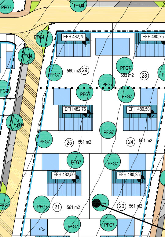

thelastscout853 Aug 2016 12:55Thanks for all the replies so far. I have attached the development plan here. Our plot is number 25, with south at the bottom, so there should be the most space for a large terrace and a nice garden in that area.
This is the first draft from our architect. However, the house needs to be rotated 180 degrees. We wanted to know how far down we need to move the house and garage to have a decent driveway.
Since these are the initial free drafts for a quote from our builder, the plot is not yet included in this, which is why I’m asking you.
I hope I explained this clearly enough.
