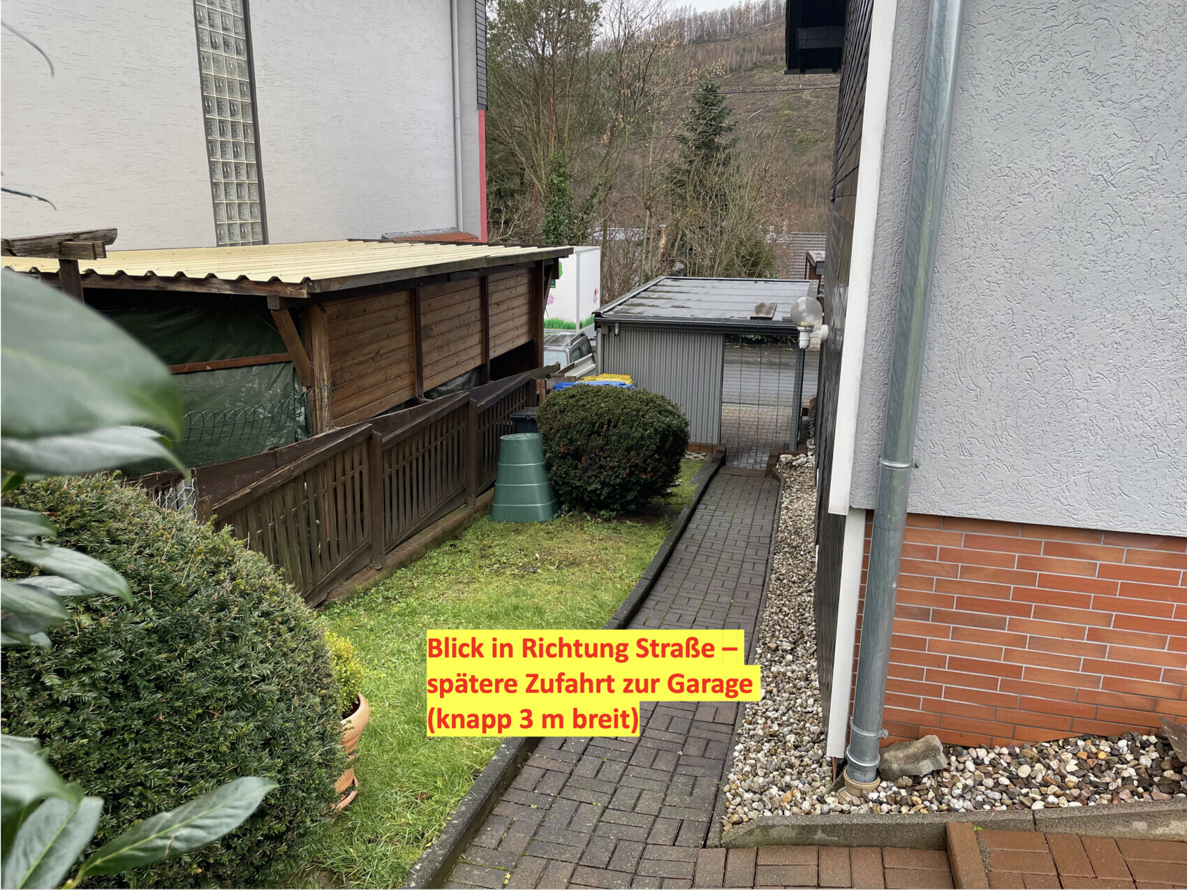

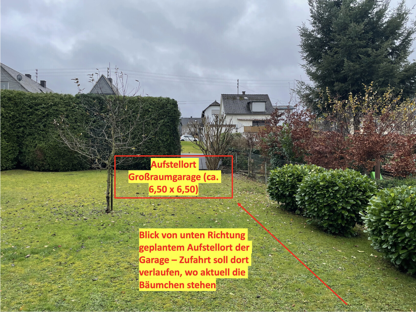

I have added a (non-professional) sketch along with some photos to illustrate the basic conditions. I have already contacted Hoffmann Garages for both a large single garage and a double garage. Pricing (including an electric door, a side door, and the electrical package) ranges between 32,000 and 35,000 EUR.
A galvanized steel garage, which would also be plastered, with similar dimensions (6.50 x 6.50 m (21.3 x 21.3 ft)), costs around 20,000 EUR. However, we definitely tend to prefer something more solid and durable, and a concrete or aerated concrete garage would probably give us a better sense of security. Installing a precast concrete garage (e.g., from Rekers Beton or Zapf) will certainly be difficult, as no truck can access the planned parking spot due to the driveway width of 3 m (10 ft).
From my online research, masonry garages appear to be significantly more expensive than precast concrete garages, or am I missing something here? The question regarding masonry is also whether a mason could simply build a garage to our desired dimensions without architectural plans, or is that a misconception on my part?
How do you assess the costs for the garage? Are the prices mentioned above reasonable? Would masonry be more cost-effective for us?
Thanks for your help!

11ant16 Dec 2021 12:10
ebi1962 schrieb:
I have added a (non-professional) sketch and attached some photos to illustrate the basic conditions.
I’m surprised that you didn’t notice yourself that your considerations seem to completely ignore the site conditions. In my opinion, the photo series clearly shows that building any garage here would be a bad idea. So it’s better not to demolish the carport—you won’t get anything better done here.

16 Dec 2021 12:23
What are you trying to tell me with that? In what way would the site be a problem? Because of the slope?
