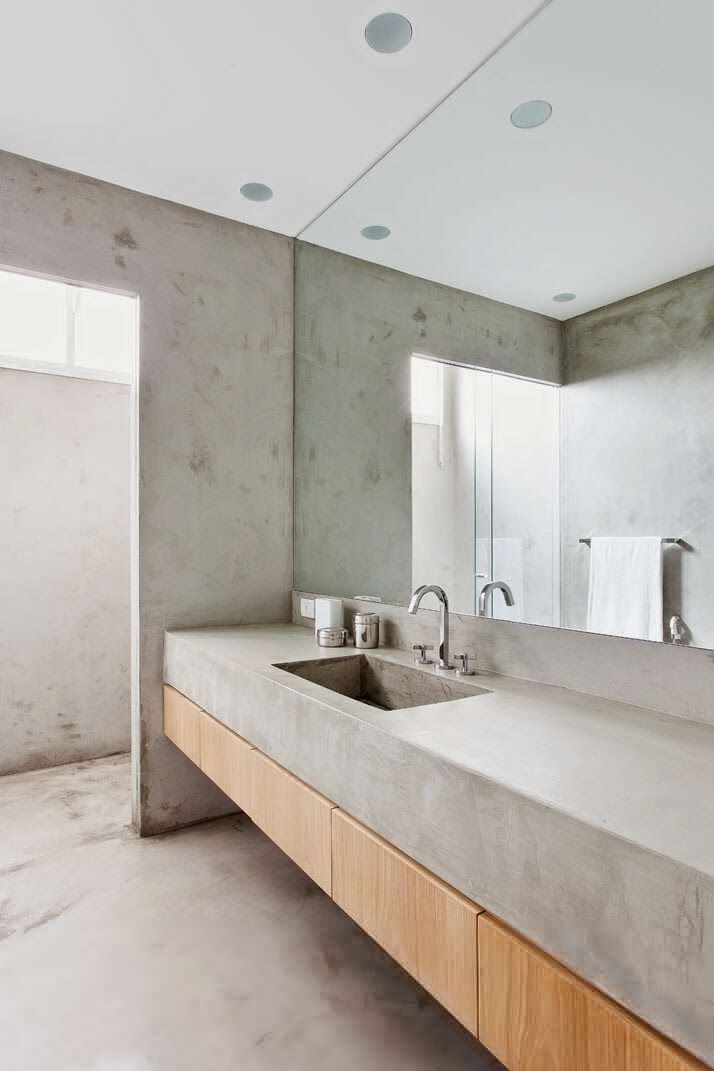

I am looking for a washbasin for the main bathroom with a concrete-look finish, as real concrete would be too heavy.
After a long search online, I came across various suppliers.
Basically, it would come down to a coating with so-called microcement, which is then sealed to be waterproof.
What I have not yet figured out is how to construct the washbasin itself.
I’m not quite convinced that MDF, for example, would be a good choice.
Attached is a picture to roughly illustrate what I have in mind:

motorradsilke19 Aug 2023 14:10There are so-called building boards available in different thicknesses. These are suitable for this purpose.

Alfredlima21 Mar 2024 14:00What have you decided on now?
I think the green drywall boards are suitable. Microcement can also be applied on OSB boards. Since microcement seals the underlying material waterproof, the substrate should hardly matter?
