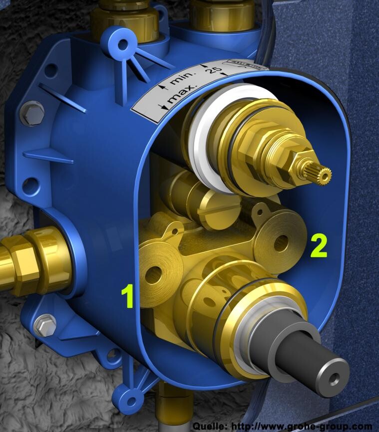

We have a Grohe thermostatic mixer in the shower, see picture.
What do I need to do to get hot water again in the shower?
Thanks for your help:
Picture of the mixer:
Below it is the Grohe Rapido T

Perhaps the hot water inlet valve is not fully opened. This adjustment is done behind the cover panel. As far as I understand, the faucet has one control to set the temperature and another knob to turn the water on and off. Such a regulator usually has a 38°C (100°F) mark. The temperature is set to this mark, the water is turned on, and the valves (hot and cold water valves behind the cover panel) are adjusted so that, on one hand, enough water flows, and on the other hand, the 38°C (100°F) temperature is reached. If the heating is turned down, not enough warm water flows through, and the water stays colder.
In short: the hot-to-cold water mixing ratio needs to be readjusted.
With other faucets, this issue might not be as noticeable because the mixing is controlled directly at the faucet rather than at the inlet valves (usually angle valves).
