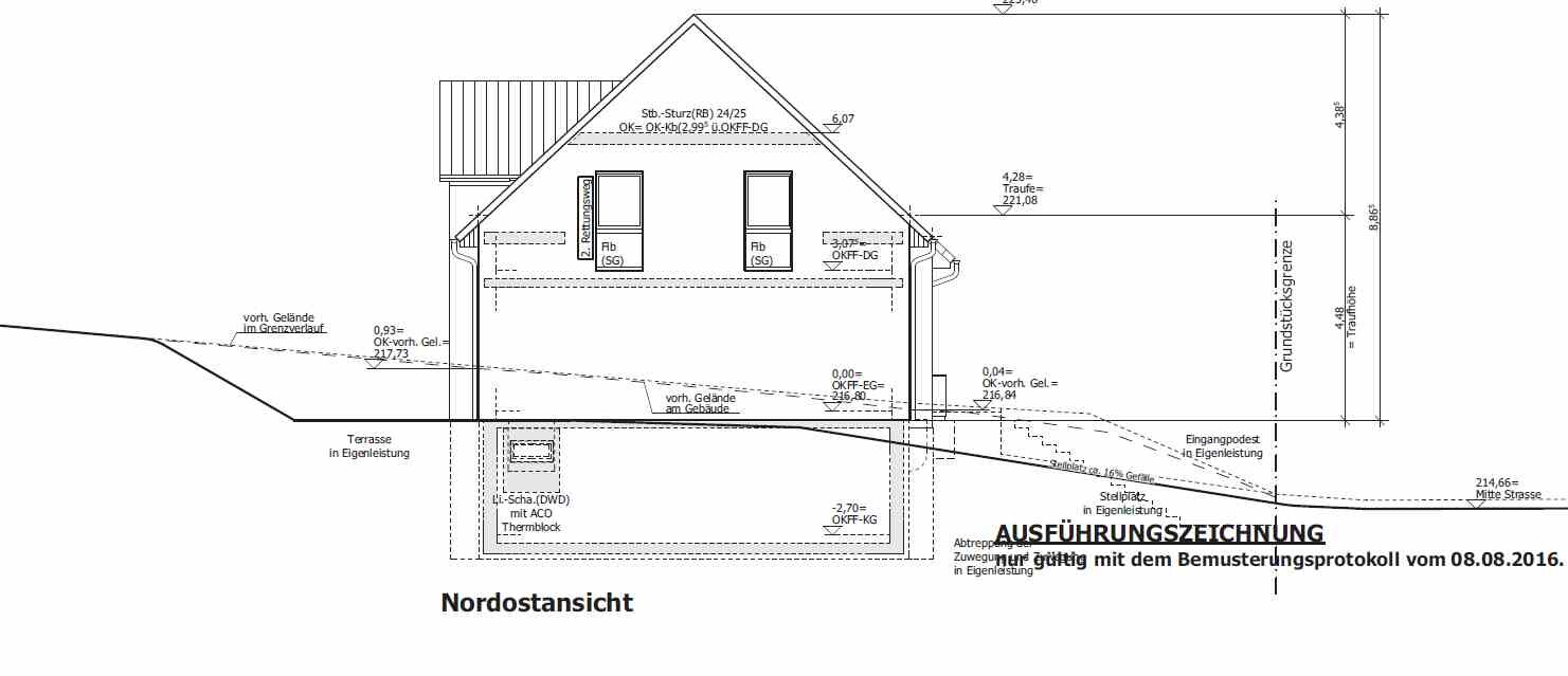

a) Is the layout of the front entrance stairs sensible? What could be improved? How should we handle the height difference to the street (214.22m to 216.60m at the house over a distance of 6m (20 feet) between street and entrance platform)?
b) Suggestions for restoring the slope in the southwest part of the plot
c) General advice on landscaping, e.g., terrace design, dealing with the additional height difference to the neighbor behind the terrace? What is an appropriate drainage solution for the terrace? What are your experiences with rainwater cisterns?
Views from our execution drawings
View before construction started
Current view:
The slope in the southwest corner has been completely removed. How should we restore it?

Hmm, why not leave the southwest corner of the building free, with a ground-level door and a proper window facing the terrace? Then add a retaining wall (either DIY using infill planter blocks or gabions, or a concrete wall). This way, you would have a ground-level parking space and ground-level access to the house, which is practical for maintenance work in the utility room and replacing boilers, washing machines, etc., as well as a room with natural light that could be used well as a workshop, gym, or playroom.
At the upper edge of the property, I would terrace the terrain and shape it with gentle curves; the embankment can either be a natural slope stabilized with plants and mats or a steep slope secured with planter blocks, gabions, or similar, depending on your preference.
