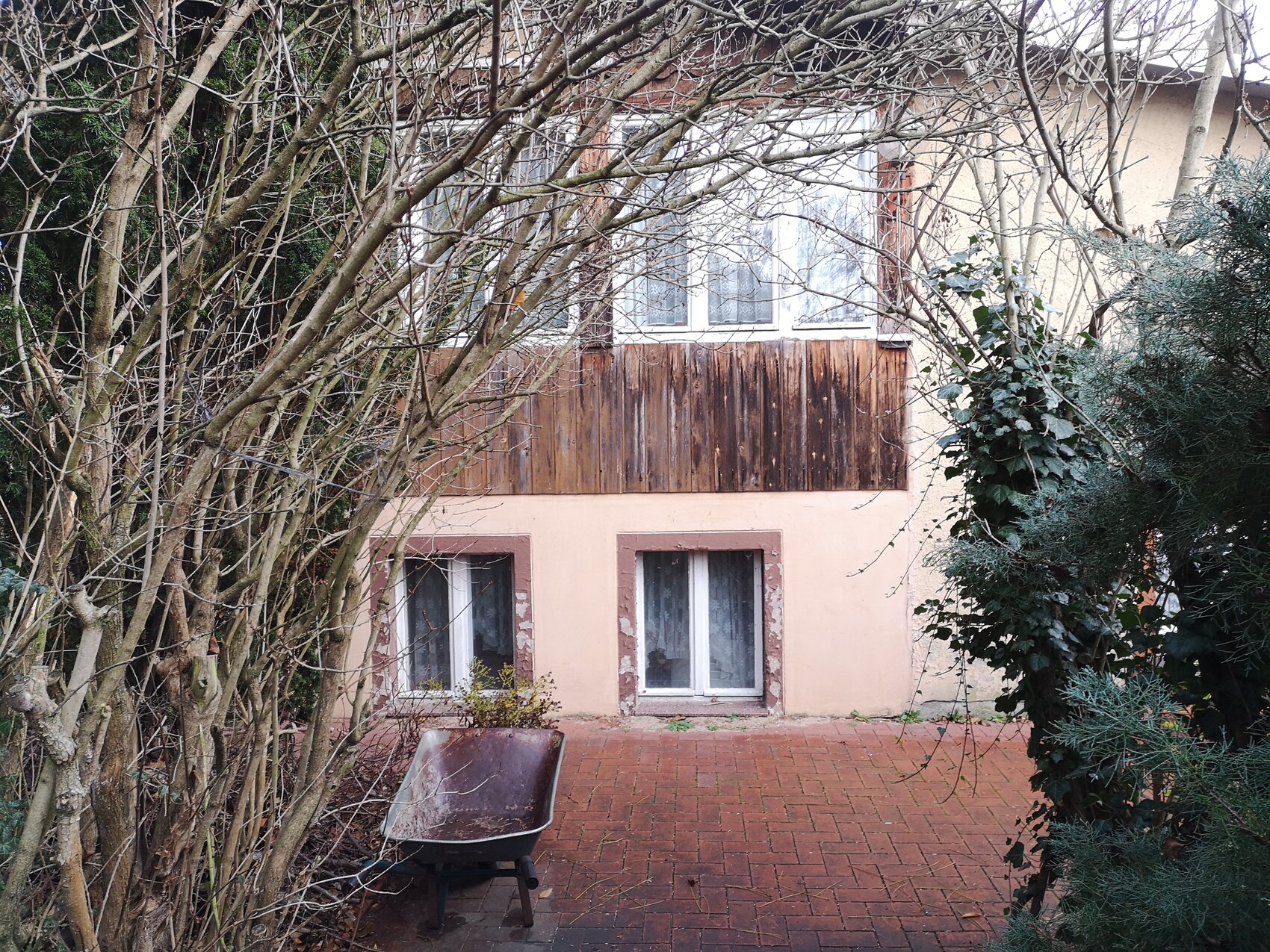

The existing house was built in the early 1900s and originally served as a kind of garden pavilion, which was gradually expanded over the years.

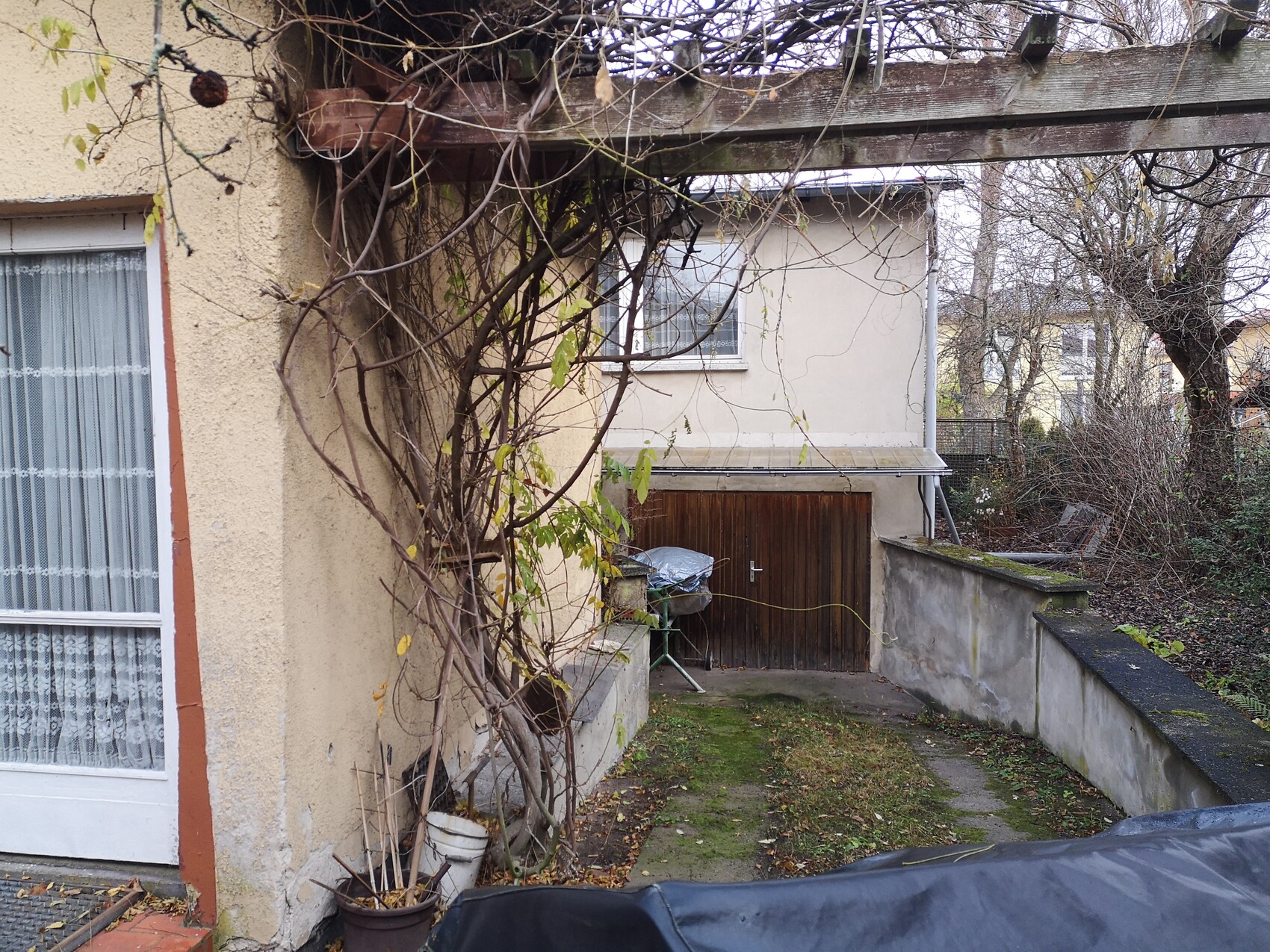

There is an attached part from the 1980s that actually includes a very nice underground garage. This section, along with the part above it, could probably be retained since the structure is solid. However, in that case, we wouldn’t be able to build the house the way we envision it.
I can share some photos here if you’d like.

It is a raised basement, so if you wanted to build the new house with a basement, the excavation would need to be extended further. I would rather call it a walk-out basement level. And yes, the "must" has to go if a ground-level entrance floor is to be built on top. If it were reduced to a crawl space, it would be too low—in short, here is my approval for demolition.
However, in this case, I tend to recommend having the house built as a developer project and only purchasing it after completion.
