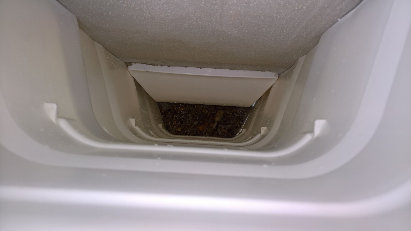

Now, seeing the units installed for the first time in reality, I noticed that they simultaneously draw in and blow out air through two openings on the left and right. Since the units are about 35 cm (14 inches) wide and are now installed inside a 40 cm (16 inch) ventilation shaft, this is completely impractical.
So, I asked Viessmann again: they were very surprised – they said such a unit would NEVER be installed in a basement, as it is not suitable for that environment, which is also stated in the unit’s manuals. The unit definitely does not function properly even in a 120 cm (47 inch) shaft.
Now that it’s clear the unit both intakes and exhausts air simultaneously, it is obvious why this is problematic. The expelled air is immediately drawn back in when the unit is placed inside a ventilation shaft. The information about the 75 mm (3 inch) duct apparently referred separately to supply and exhaust ducts. Honestly, I didn’t mention to them on the phone that the unit was intended for a basement; I just asked about the duct diameter.
