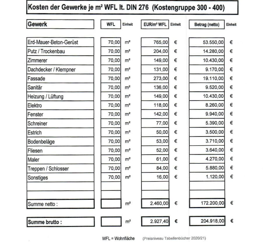

I am planning a single-story extension and was recommended an architect for the building permit / planning permission. He spontaneously created a design that does not meet my requirements at all (living area 30% smaller, entrance on the wrong side, utility rooms far too small, but a huge unwanted open-plan kitchen, etc.). When I informed him that everything differs from the written specifications, I only received his fee proposal (Fee Zone III, middle rate). He estimates costs of over 200,000 euros for 70 sqm (750 sq ft). I consider this to be vastly exaggerated, especially since the actual building area is around 100 sqm (1,080 sq ft). Many of the listed items I will do myself anyway or will not be realized at all (such as stairs).
Can someone tell me whether the individual items he includes must necessarily be part of the invoice and if the amounts are justified, or where I can compare the amounts?
Is every item always multiplied by the total living area?

He created a draft spontaneously that does not meet my specifications at all (living area 30% smaller, entrance on the wrong side, utility rooms far too small, but a huge unwanted open-plan kitchen/living room, etc.). When I pointed out that everything deviated from the written requirements, all I received was his fee proposal (fee zone III, average rate). He estimates costs of over €200,000 for 70 sqm (750 sq ft). I consider that extremely exaggerated, especially since the actual building area is around 100 sqm (1,075 sq ft). Many of the listed items I will do myself or will not be implemented at all (like stairs). 1. What exactly did you commission? Is there already an architect contract? You mention you received his fee proposal. What does all this mean, or how did it proceed?
2. To earn his fee, the architect must provide you not just any design, but the design you requested. Therefore, unless you have formally commissioned him, the architect has not yet earned any fee.
3. The cost estimate of €2,850 per sqm (265 per sq ft) of living space is realistic and appropriate for calculating his fee. Whether you hire craftsmen for the work or do everything yourself as a worst-case scenario is irrelevant for the fee calculation.

Whether you ultimately hire contractors for the work or, in the "worst" case, do everything as a DIY project, this does not affect the fee calculation. However, the cost accounting is carried out throughout all service phases, and the fee is always adjusted to the actual current costs.

3. Thanks. At least he is honest with me. What makes me suspicious is that friends who built a larger extension paid their architect (who lives farther away) a flat fee of €2000 plus VAT until the building permit / planning permission. I’m surprised that I’m supposed to pay about four times as much for less. I’ll probably need to have a clarifying conversation with the architect and, if necessary, hire someone who is significantly cheaper than the rates according to HOAI. After all, HOAI is no longer mandatory.
