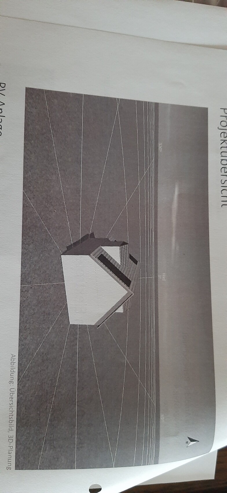

Here is the small system.

- What should be considered regarding the small gable related to shading? Different arrangement?

boxandroof4 Sep 2019 18:211. You can easily get 15 kWp or more on that. Do it! For example, the south-facing gable roofs. Only north-facing gables are unsuitable. Areas north of the gable at the bottom might be borderline, but that can be simulated. Leaving some space on the side south of the gables doesn’t make much sense, except maybe due to specific string lengths.
2. For effective shading management, there are several options. The inverter must be capable of handling this, and it depends on the module string configuration to work well. If it’s not feasible with a conventional setup, then SolarEdge is an option.
3. A 70% hard power limitation seems sufficient from my gut feeling.
