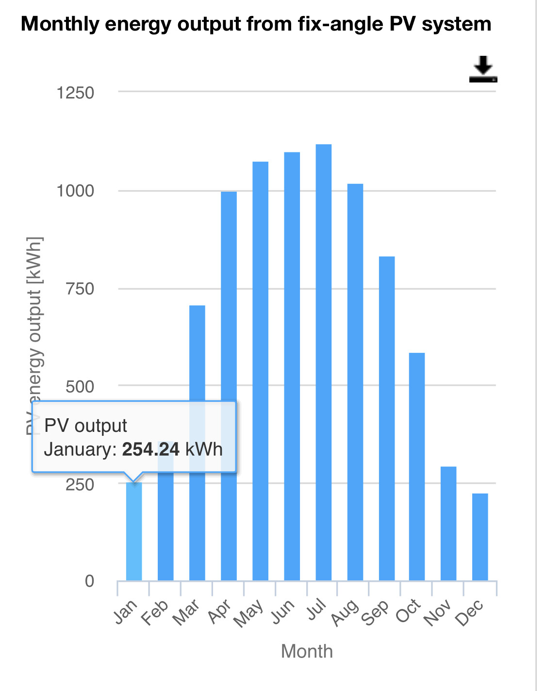

Here in Middle Franconia, according to PVGIS, the photovoltaic system loses about 3% of its annual output in January. This means you will hardly notice it with regard to the heat pump, but that doesn’t mean photovoltaic power is a bad investment over 10 to 15 years—quite the opposite. However, you should forget the idea that the photovoltaic system will noticeably support the heat pump. If, for example, you plan to use a ductless air conditioner or other high-energy consumers in the summer, the energy is practically free.

Zaba12 schrieb:
In Middle Franconia, according to PVGIS, about 3% of the annual photovoltaic output is lost in January. This means you probably won’t notice much difference regarding the heat pump, but it doesn’t mean that a photovoltaic system is a bad investment over 10-15 years—quite the opposite. However, you should forget the idea that the photovoltaic system will noticeably support the heat pump. If you plan to install, for example, a split air conditioner or other high-energy consumers for the summer, the electricity generated is practically free.
You have hot water available all year round, and the storage tank can be efficiently charged or even overcharged with photovoltaic energy around midday. Even during transitional seasons, you can use midday electricity to heat the building.

hegi___ schrieb:
You have hot water available all year round, and the storage tank can be ideally charged or even overcharged with the photovoltaic system around midday. Even during the transitional seasons, you can use the midday solar power to heat the building.
Certainly from the end of March to early October. But I was referring to the darker months when the heat pump’s consumption is highest. You can check PVGIS yourself to see how much solar energy you get in December, January, and February. Here in the south, it’s just under 3% of the annual yield. With a maximum of about 8 kWh per day, does any of that really go towards heating the hot water when you consider other consumers like controlled mechanical ventilation, refrigerator, and everything else running in standby? Even the storage tank itself consumes electricity!
However, I can report firsthand starting next week whether the tank fills up. I have a suspicion.
Monthly PV electricity production: bar chart (Jan–Dec) in kWh.
