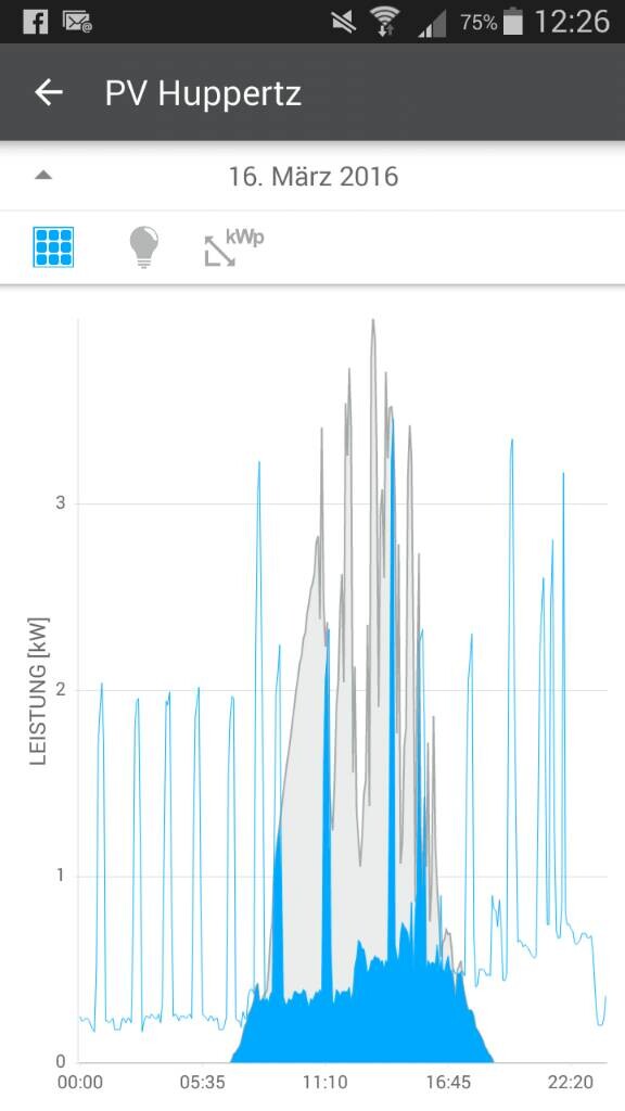

toxicmolotof3 Jul 2016 12:32@alter0029
I assume you also have a heat pump? Could you please upload a load profile from March 16th?
This would clearly show that photovoltaic systems donât provide much benefit for a heat pump (which doesnât mean that photovoltaic systems are bad or uneconomical).
The blue line represents electricity demand, the gray area shows photovoltaic production, and the blue shaded area indicates how much of the self-consumption is covered by photovoltaic.
We are looking at a sunny day in March, so not deep winter but about midway between summer and winter.
The heat pump compressor is clearly visible.
alter00293 Jul 2016 12:36Iâm not that far yet. Construction has not started here. An air-to-water heat pump is confirmed, but Iâm still undecided about the photovoltaic system; however, I am preparing everything for it.
toxicmolotof3 Jul 2016 13:00That generally doesnât cause any harm, but I would advise not to follow the argument that heat pumps plus photovoltaics are ideal unconditionally and blindly.
What do you mean by 50%? The photovoltaic share of total consumption (self-consumption) or the self-consumption rate of total production?
