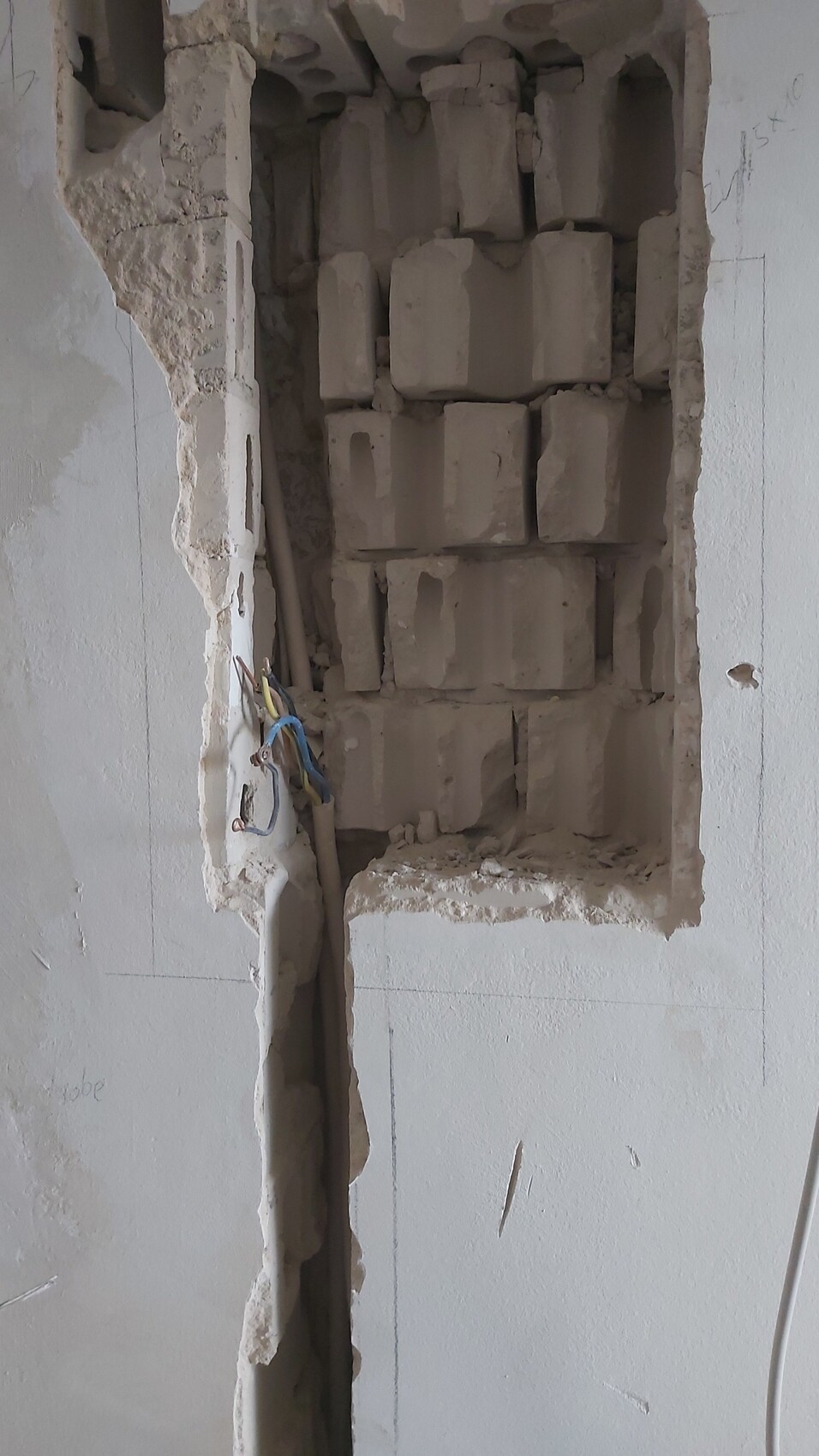

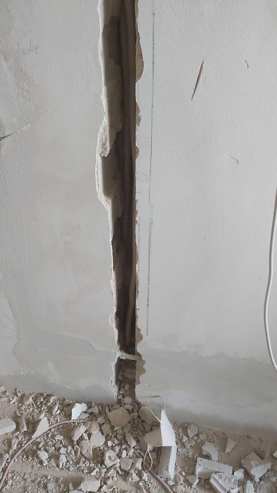

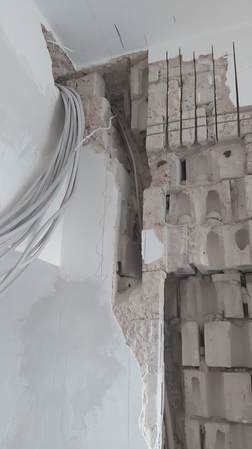

Uh, no, behind. If I understand correctly, you chased a cable out from the opposite side of the wall. With such a haphazard approach, I probably don’t need to suggest that you illustrate your thread with floor plans. But maybe with photos?When chasing out the cable, I of course worked on the side where the electrical panel is located. The assumption was that the cable also runs inside on that side. Actually, it ran diagonally inside the wall. I’ve attached some photos. The same applies to another floor.

Hands folded and off to the structural engineer I spoke with a bricklayer. He said it might be possible to rebuild it neatly using expansive mortar and by removing the bricks. I would like to put this up for discussion.
T_im_Norden9 Jul 2020 15:18I would not rely on the expertise of a bricklayer.
There is a good reason why structural engineers need to study.
The third picture in particular looks like you tried to perforate the house crosswise with an angle grinder :-(
