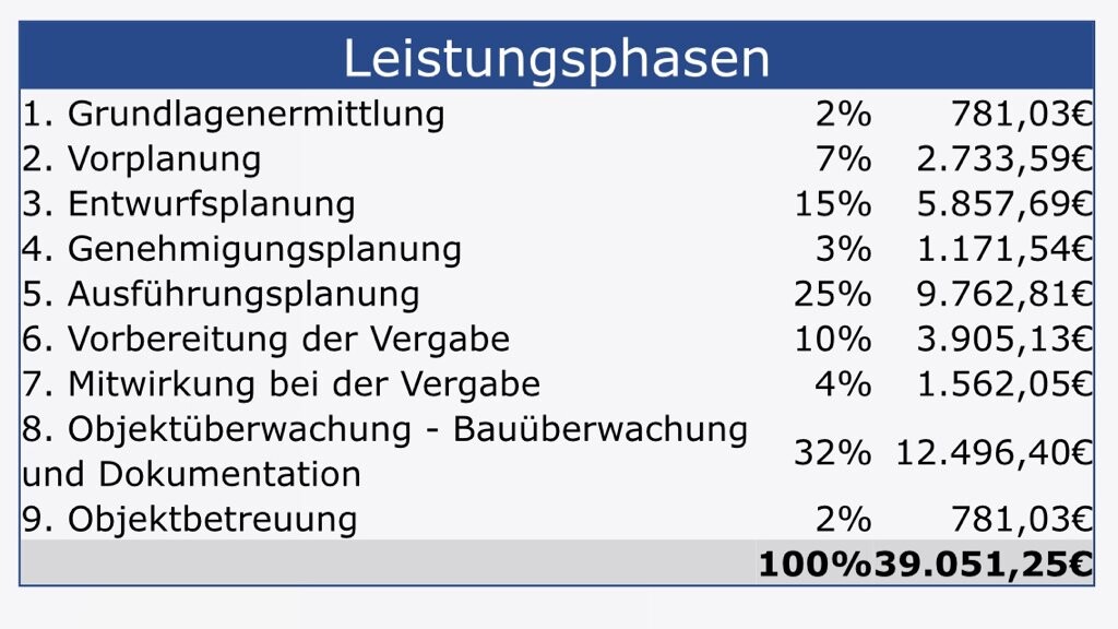

I believe that if an architect is currently designing their second single-family home, the result will likely be poor. And a few hundred single-family homes is not a huge number, especially if you have a team with separate roles including an architect. The architect might earn around 12,000 to 15,000 EUR for service phases 1 through 5 and needs to generate about three times their gross salary, meaning at least 9 houses per year for the office to break even or just be profitable. After 11 years, perhaps in their early 40s, an architect specializing in single-family homes should have completed around 100 houses (excluding site supervision).

MIA_SAN_MIA__17 Apr 2017 20:5640k would include construction supervision, right? I’m interested in how much the planning process up to the submission would cost. So without construction supervision.
MIA_SAN_MIA__17 Apr 2017 21:14Thanks, I can work with that.
