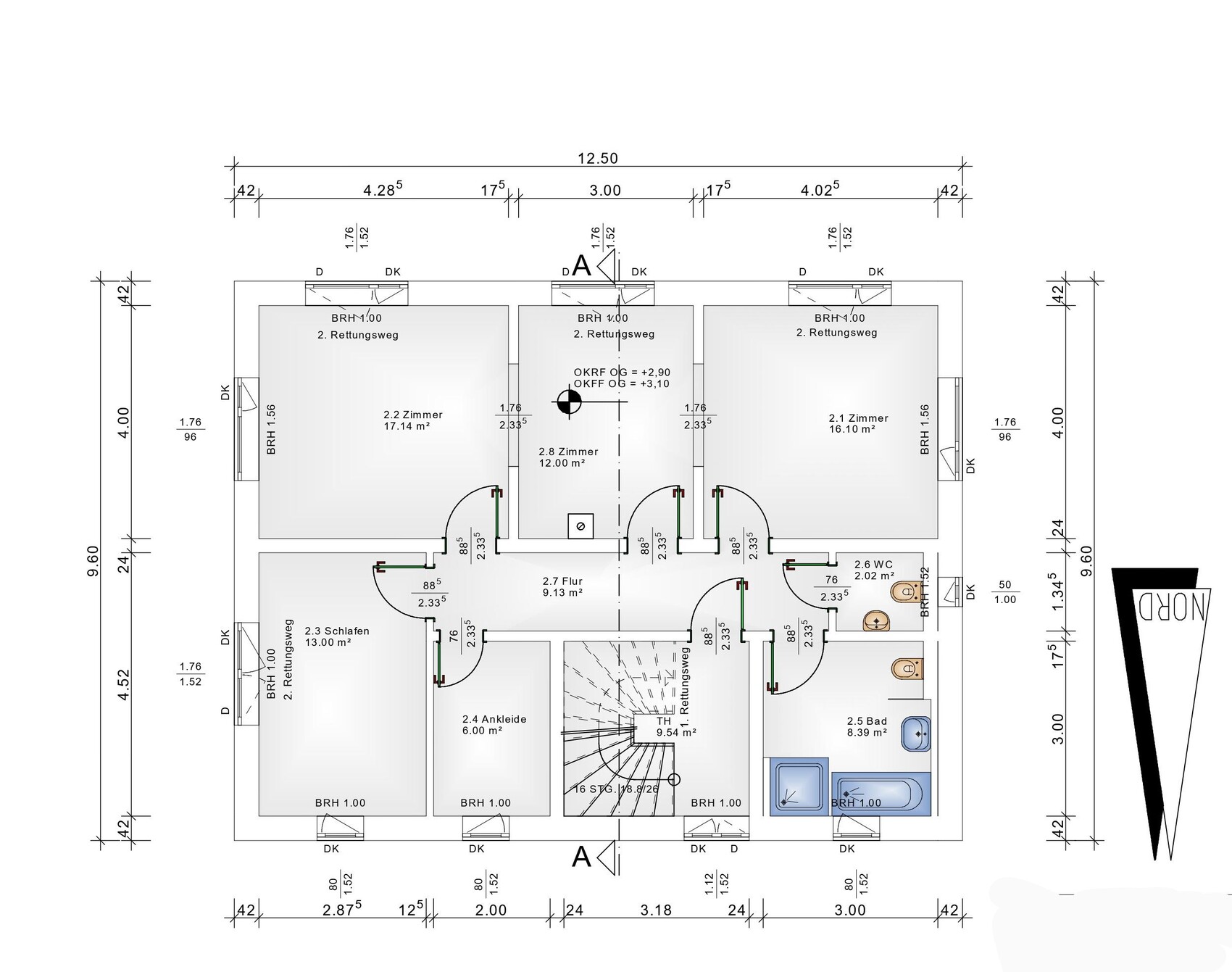

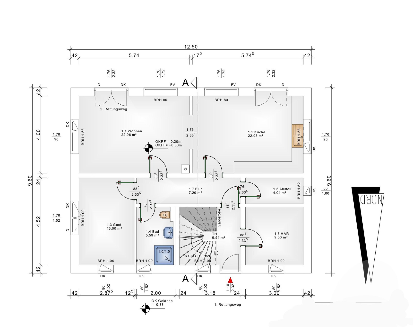

Dizzy05Hello,
We are currently working on the floor plan design. Attached is the architect’s proposal. Overall, we like the layout very much, but I feel there is unnecessarily large living space lost to the hallway/entrance area/staircase. Does anyone have suggestions for improvement?
Plot size: 2,200 m2 (0.54 acres)
No slope
Location: Saxony-Anhalt
Number of stories: 2 floors
There is no formal development plan; the building should just fit the character of the street (residential area only)
Style, roof type, building type: simple design, mono-pitched roof
No basement
Number of occupants, ages: four people, including two children of preschool age
Space needs on ground floor: living room, large kitchen, pantry, WC with shower, guest room, utility room
Space needs on upper floor: master bedroom, walk-in closet, three children’s rooms, bathroom, additional toilet

Dizzy05 schrieb:
Floor plan flexible and adaptable, it could be converted into two separate units later Dizzy05 schrieb:
It is important to us that the single-family house can be divided into two separate living units The two living units are very well designed.
I am looking for a single-family house where one family lives. To me, this floor plan does not resemble a single-family house.
Benzeller29 Jun 2022 07:32On the ground floor, the dining table must be placed in the kitchen, otherwise the living/dining room becomes very cramped with the sofa.
I would prepare the door to the hallway but not install it, to allow easier access to the pantry when carrying groceries.
In the upper floor, one child's bedroom is noticeably smaller than the other two.
The walk-in closet lacks an access to the bedroom.
Living in the house alone (so just one dwelling unit) seems really difficult to me... Nothing quite fits properly.
For two dwelling units, everything is probably fairly well divided and mostly makes sense, but in my opinion, it’s not very suitable as a single-family home.
The most important and nicest room in the house is, of course, the living/dining/kitchen area – here I miss a proper dining space.
Your living room is already quite small, and it will be almost impossible to set up a suitable dining area since the kitchen is in a straight line next to it. I also find this visually very challenging.
