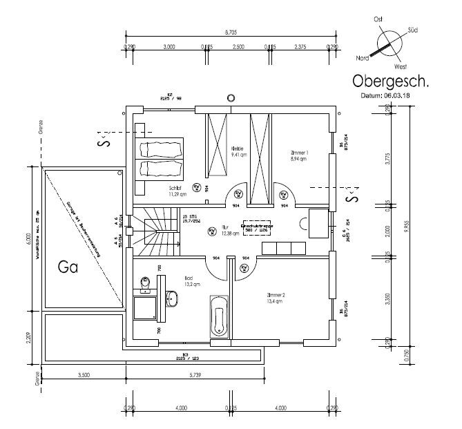

rhönschaf8 Mar 2018 15:10Hello everyone,
We are now close to submitting the building permit / planning permission and would like to hear opinions from experienced homebuilders. We have already shared the design with friends and family, but we want to benefit from your experience and knowledge.
Thank you in advance!

We have finalized the floor plan and window placement. As laypersons, we don’t see any details we’ve forgotten. We have little storage space, which we know, but we can live with it (the garage will be a storage room for winter tires, bicycles, and everything frost-resistant).

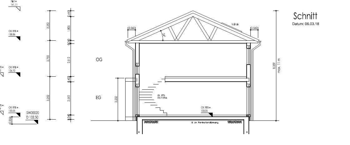

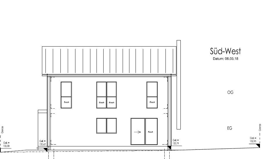

We have elevated windows in the living room and bedroom (rooms are one above the other). What do you think about this? We want no direct view into these rooms. Neighbors surround us on three sides.

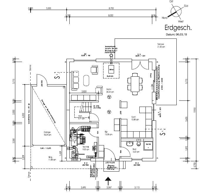

just a quick question: where is the TV supposed to go? 3.75 m (12.3 ft) is probably a bit narrow for both a sofa and a TV.
What are rooms 1 and 2 intended for? Try placing some furniture in the plans and consider whether it might make more sense to move the doors (including the bathroom door) away from the dividing walls, so you could place wardrobes behind them (about 70 cm (28 inches) deep in the rooms would be best).
Also, think about whether you really need a walk-in closet if the house is this small! Especially since the walk-in closet is even (slightly) larger than the possible (children’s) room 1!?
As far as a functional design.
I think the ground floor is pretty good, as long as you like an open layout and aren’t bothered by the staircase being in the living area.
Where would you place a TV?
The upstairs layout seems less practical to me, although the original post doesn’t make the plans for children very clear.
As it stands, there is really only one child’s bedroom. The smaller room can certainly be used as an office or guest room, but it’s quite tight as a child’s bedroom.
On the other hand, the bathroom is comparatively unnecessarily large.
I would reduce the bathroom size (to about the size of the current “small” room) and move the bedroom next to it to the northwest side.
This would create space on the southeast side for two decent-sized rooms, giving you flexibility if there is more than one child. If not, the guest or home office user can enjoy a spacious room.

quick thoughts as well:
The ground floor looks quite good. I think having a shower downstairs is unnecessary. Remove it and instead create a small pantry – voilà – more storage space gained.
For the upper floor, I recommend the classic layout. Bathroom and bedroom on one side, two kids’ rooms on the other side, with a walk-in closet opposite the stairs.
Quickly borrowed sketch, ignore the square meters:
Kaho, if someone with a dog wants a shower on the ground floor, you can’t just dismiss that as unnecessary. We have often been glad to have a shower on the ground floor with two dogs. In winter, you don’t want to hose down the dog outside if possible.
An alternative to the shower is an outdoor water connection with hot water at the front.
I don’t like your upper floor either; even though it’s larger than our semi-detached house, everything feels much smaller. I don’t have many ideas right now, especially just on my phone...
