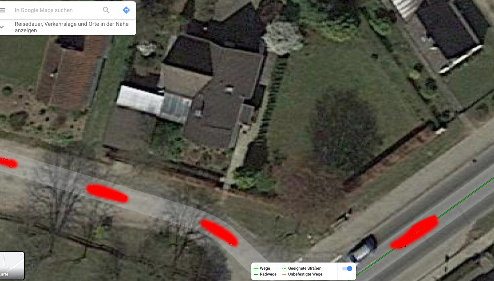

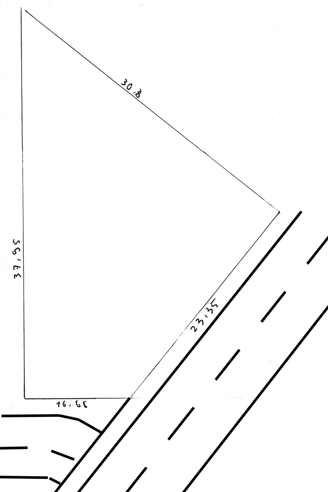

Hello dear forum community,
My fiancée and I are currently planning the construction of a new single-family house. We are searching for a plot of land and have one in mind that might be somewhat difficult to build on due to its shape and location.
Attached is the approximate floor plan. The plot is 460 m2 (5,000 sq ft) in size. Along the long edge at the lower right runs a main road. At the adjacent edge on the lower left is a smaller street branching off from the main road.
The plot is not located in an area covered by a zoning plan, but within an unregulated inner area.

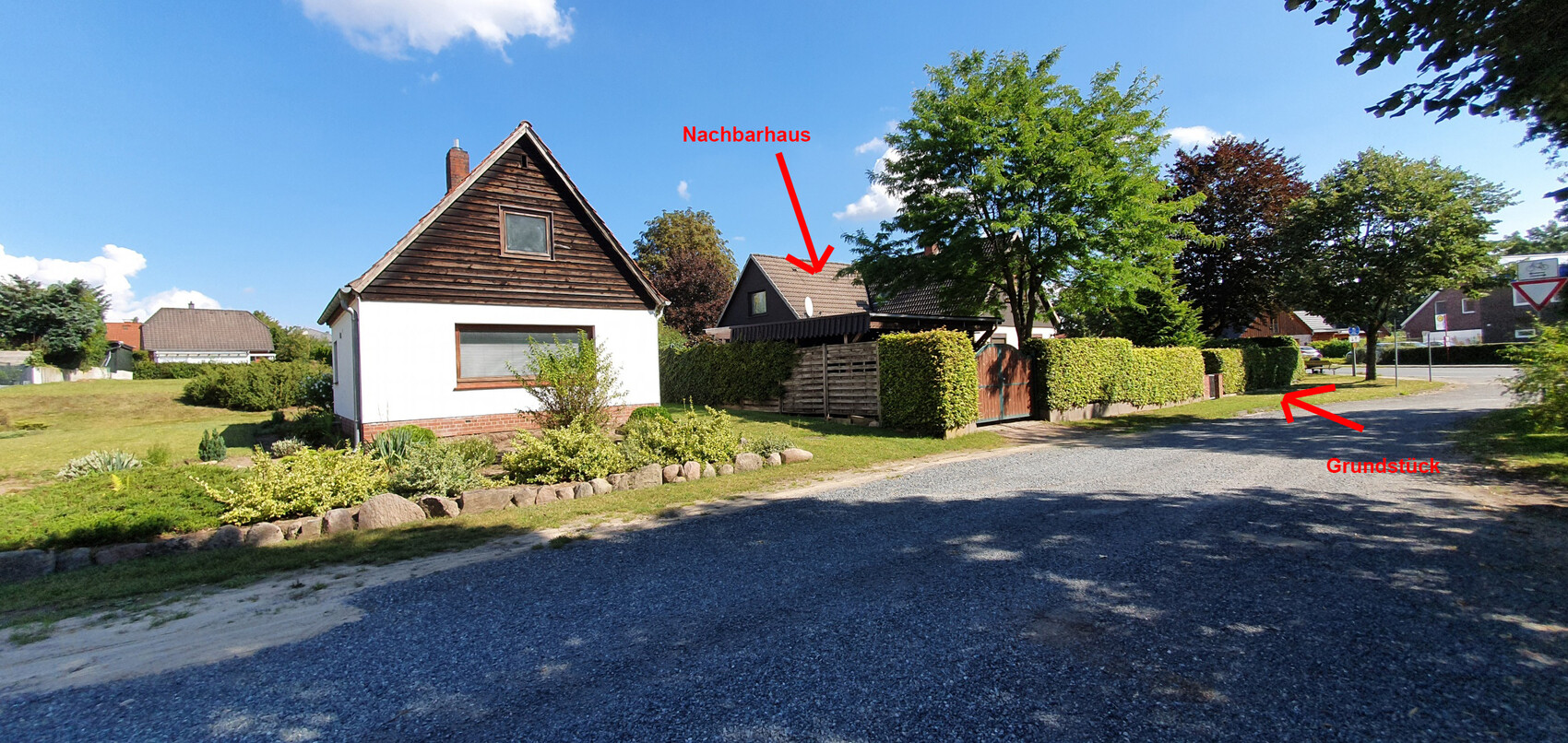

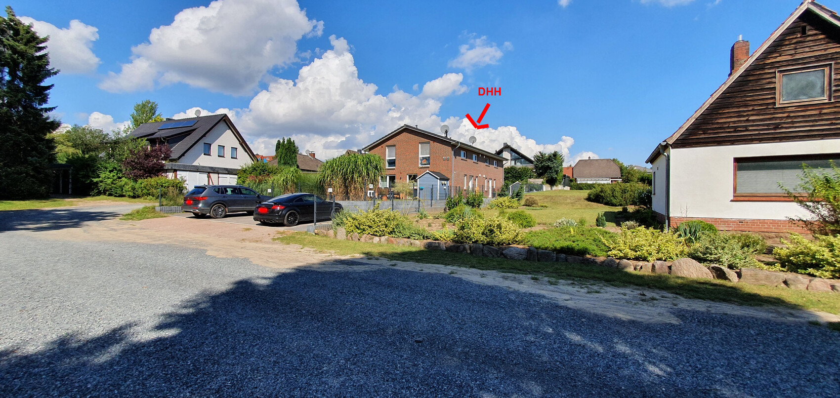

The two directly neighboring buildings are one-story residential houses with pitched roofs (without a knee wall). Next to them is a building gap. Beside that is a larger semi-detached house, which in my opinion has two full stories. So, a pitched roof with at least a 1.8 m (6 ft) knee wall.
The question we are now asking ourselves is whether it is possible to build a house on this plot that meets our requirements.
We would like to build a single-family house with a footprint of approximately 90-100 m2 (970-1,075 sq ft) and a living area of 150 m2 (1,615 sq ft).
What I have already found out is that there was a positive preliminary building inquiry for this plot for a single-family house with one full story and a 100 m2 (1,075 sq ft) footprint.
What do you think:
- Is it even possible or practical to build such a house given the irregular shape, while still leaving some garden space?
- What is the general situation regarding access roads to the plot? So far, there is none. The plot was apparently once divided from the adjacent one. Is it conceivable that permission could be granted for an access road from the main street? What kind of costs might be expected?
- I am having trouble understanding the calculation of full stories in Lower Saxony. I know that a height of 2.2 m (7 ft 3 in) may not be exceeded for more than two-thirds, otherwise it counts as a full story. But what does that mean concretely? What kind of knee wall height can I roughly expect?
- Is the semi-detached house still characteristic for the neighborhood in such a way that I could perhaps even build two full stories?

EDIT: I have attached a top view image as well as pictures of the neighboring buildings
