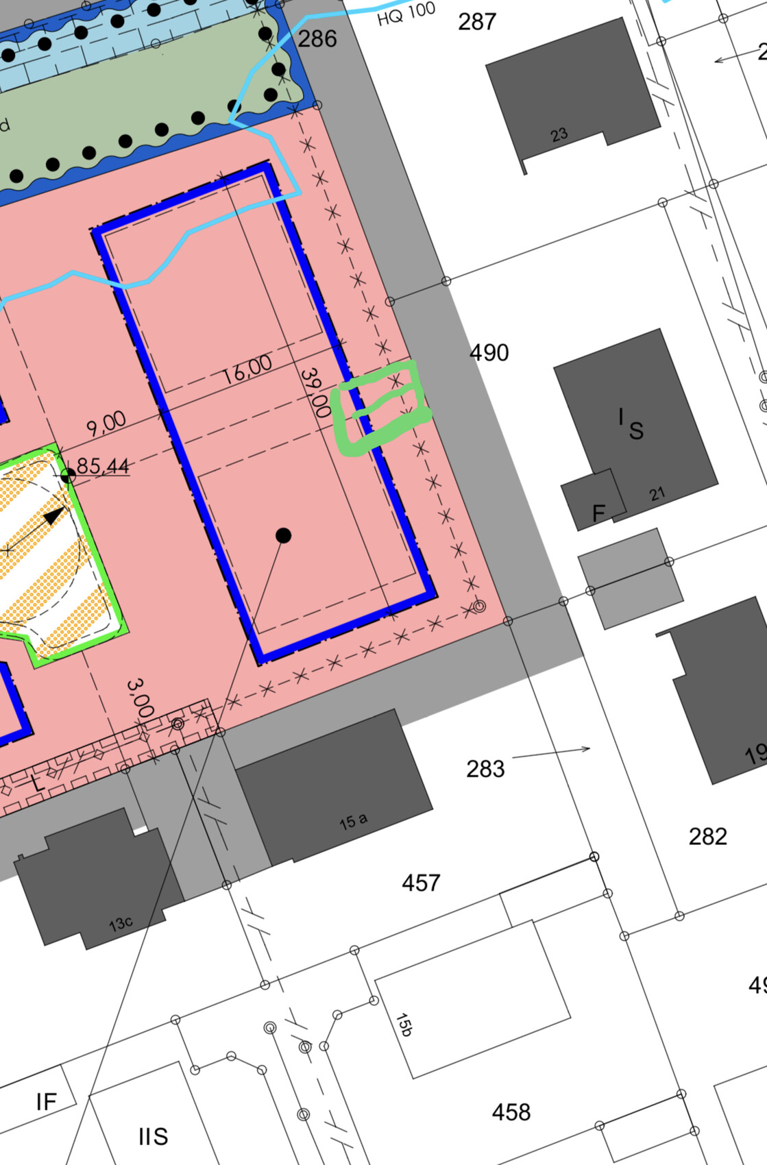

So, according to the zoning plan, the garages are supposed to be located here:

dobbelhaus20 Jan 2019 08:58Caspar2020 schrieb:
Is this the house in the east or the south?
Regardless; the only boundary where a garage could be placed would be the one next to the second new upper plot.
The building area is 16m long (running from west to east; a garage typically 6-9m.

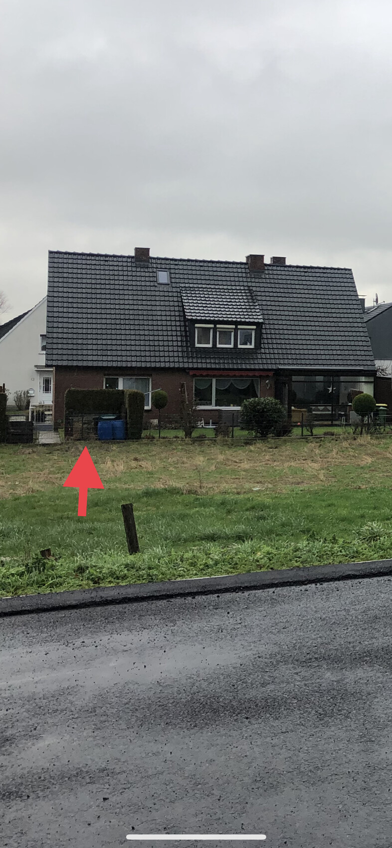

I don’t see any issues regarding existing buildingsThis is northeast of my property, where the neighbor has his western garden, which is his only one with a patio.
It is true that the building area is 16m long, but the semi-detached house will use all 16m of it (8+8).
This spot would also be the only one allowed for 2 garages according to the development plan. (marked in green)
dobbelhaus schrieb:
This location would also be the only one allowed for two garages according to the development plan. No. You could place the garage along the southern boundary, exactly extending the front building line. Two parking spaces there, where you had planned the garage in version 1. Of course, this would need to be carefully checked against the floor area ratio and front yard coverage, but by visual estimation that should work. However, there would be no usable garden left. The floor plan with limited south-facing windows would also have to fit this arrangement.
