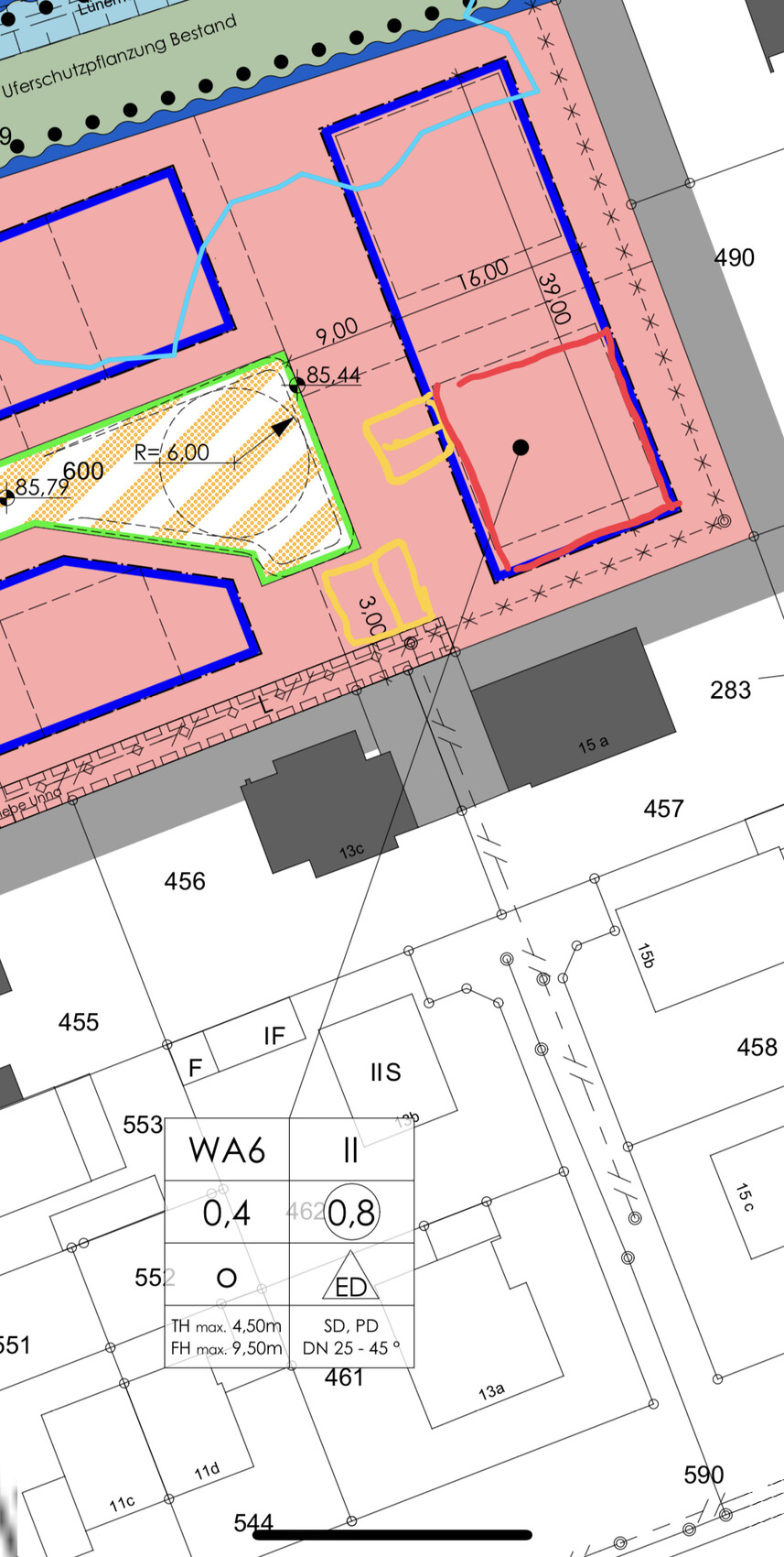

dobbelhaus19 Jan 2019 09:21Escroda schrieb:
I haven’t checked your form details for accuracy. But your other thread shows that there are some less obvious factors affecting the floor area ratio here. According to the development plan, a garage in the front yard is not allowed, so it must be built beside the house. This results in a long driveway and reduces the buildable area for the house. With a double garage (6m (20 feet)) there would be less than 15m (49 feet) left for the house, as the building plot width is apparently only 19.50m (64 feet). Alternatively, the garage could be placed on the south side, which would further extend the driveway. Without a site plan, it’s hard to see everything.That’s really tough for me 🙁
I would like to have the garages on the right next to the turning circle, but that seems not possible due to insufficient setback. Then I thought about placing them in front of the street, directly next to the house, which would meet the required 3m (10 feet) distance from the road.
But if that area counts as front yard, I would have a problem.
I’m uploading a picture and have highlighted the two possible garage locations in yellow and the house in red.
If that’s not possible, how else could it be done? You wouldn’t build a garage directly in the south garden in front of your terrace, would you?
On the north side, a long driveway next to the neighbor’s boundary hardly seems desirable from the planner’s point of view either.
dobbelhaus schrieb:
Apparently not possible due to lack of setback area. The garage does not require a setback area if it is not higher than 3m (10 feet) and not longer than 9m (30 feet). However, in my opinion, the development plan excludes both positioning options. Due to the special plot situation, I consider the first option, unlike the second, not entirely impossible, as this plot is particularly disadvantaged compared to the other building plots by paragraph 4.1 of the written regulations. But I see you depend on the goodwill of the permitting authority, because your request is, in my opinion, not legally enforceable.
dobbelhaus schrieb:
If that doesn’t work, how else could it be done? You will probably have to ask the city planner who drafted the development plan. I also don’t understand why a 9m (30 feet) distance has to be kept. But the experts have studied this and surely have their reasons. However, this won’t help you since the development plan is now legally binding and probably no one will initiate a change.
So, go to the planning office on Monday before committing to purchase and get a written statement that the garage is approval-worthy outside the building area. Or, if necessary, you can do without the garage, as parking spaces are allowed everywhere (observe area restrictions).
