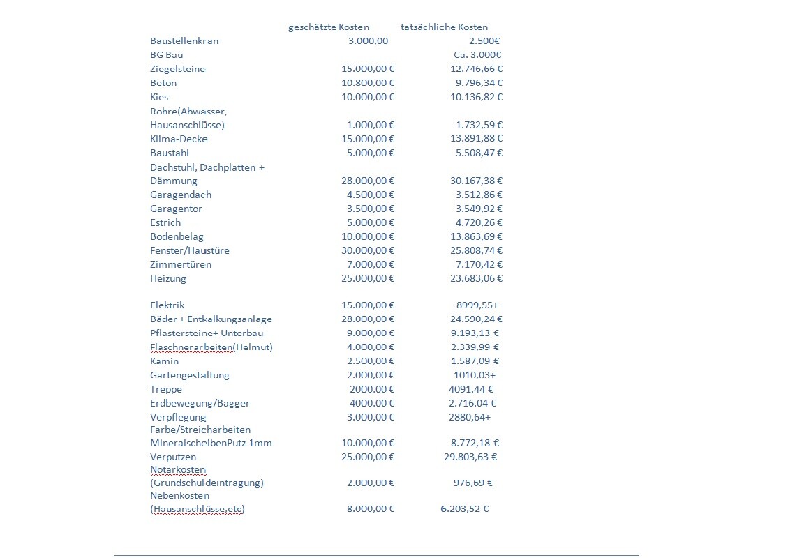

PS: Is there interest in the detailed cost breakdown?

Stefan8904 Oct 2018 17:50It's great to see projects like this succeed. I would appreciate more details. Which trades were subcontracted?
Selbstbau4 Oct 2018 17:53Please provide the text you would like me to translate.
Selbstbau4 Oct 2018 18:15Thank you for your feedback.
We also had help with various trades. For example:
- I can’t handle the building permit/planning permission, drawings, or structural engineering, but my former company can. So I went there and talked to my former boss, who agreed to put his company stamp on the documents, even though he doesn’t earn anything from me/us. I did this with the architect in the evening after his working hours. All the plans, structural engineering, building permit, etc. cost €1300 (about $1400) — how great is that? 😀 (official invoice)
- Electrical work: I can’t connect or wire a distribution board, but a very good friend who is an electrician did it for free 😉
- Roof structure: I can’t build the roof frame either, but I can take time off work and help the carpenters raise it (this only works because the carpentry company is local and we know each other). The roofing is done by an electrician again.
Primarily, of course, it was about saving money—I am Swabian (a true Swabian) 😀
Lobster schrieb:
I find it interesting what the intention behind the project was. Was it about saving money? Getting more out of the invested capital, or was the experience and the project itself the main focus?
