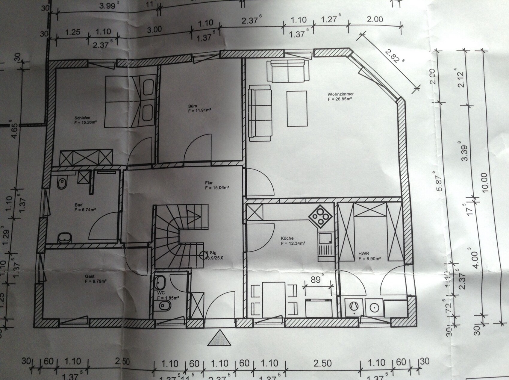

A bungalow doesn’t waste space; it simply arranges the available area all on one level.
The pictures, which hopefully can be opened, show what I consider a well-designed bungalow with a somewhat steeper roof, making the attic function as a substitute for a basement. This way, you live on the main floor and use the upper floor for storage of your belongings. It also provides a space for drying laundry, storing suitcases, boxes, Christmas decorations, etc. Ideally, there is a staircase leading upstairs instead of a hatch with a ladder. Karsten
