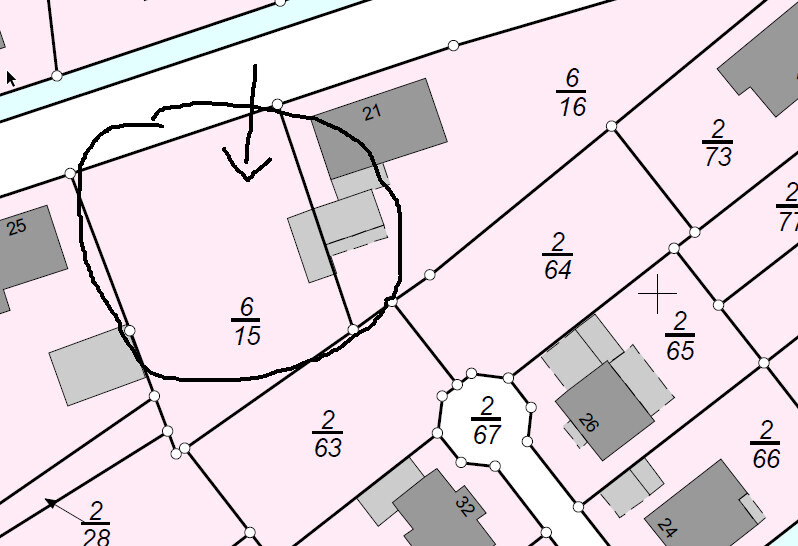

Plot size – approx. 1060 sqm (11,409 sq ft)
Slope – none

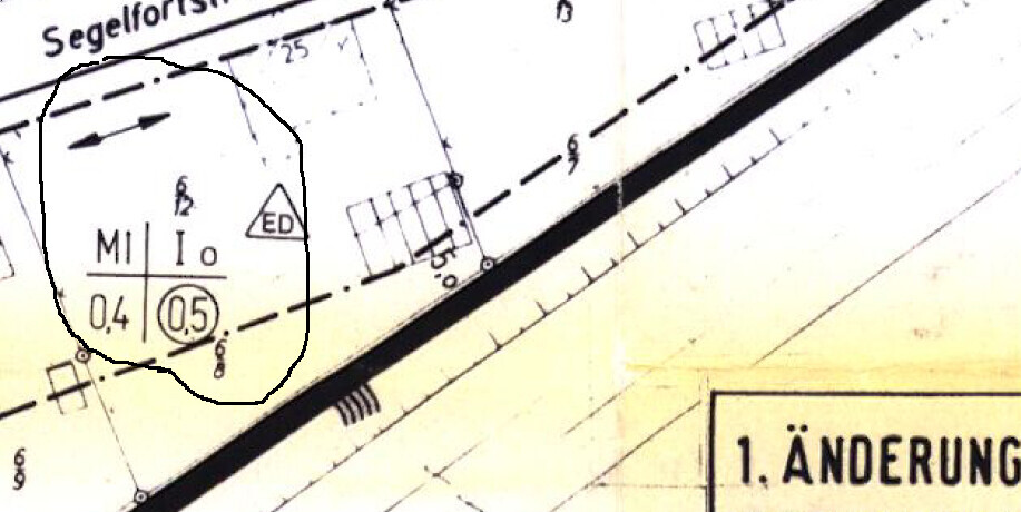

Floor area ratio – 0.4
Plot ratio – 0.5
Building window, building line, and boundary – planned 5 m (16 ft) from the street

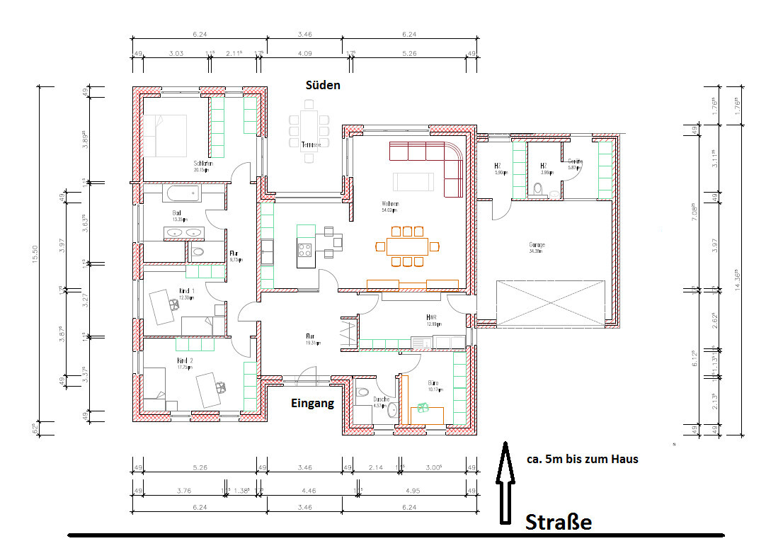

Floor plan of a single-family house: entrance, hallway, living room, kitchen, bathroom, bedroom, garage.
face2630 Jan 2019 15:58
I haven’t really looked at the floor plan yet, but I’m already confused. Either I’m having a mental block, or something isn’t right with the directions!?
If the top of the plan is south, then the right side can’t be east.

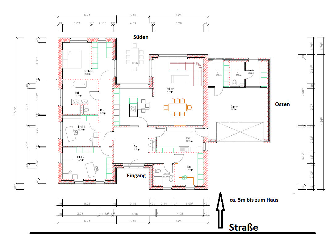

AleHer020930 Jan 2019 16:06
Ahem, there was a small slip of the pen in the designation...........it definitely needs to be changed...

I got stuck there as well.
Are more children planned, or are Child 1 and 2 placeholders for hobbies, guests, or work?
AleHer020930 Jan 2019 16:16
Hello, I can’t explain it right now either ;(. The garden is indeed facing south, the entrance is on the north side.
The children’s rooms are currently just placeholders, as there are no children yet.
EDIT: Unfortunately, I cannot edit the original post, but I would like to prevent further misunderstandings.

face2630 Jan 2019 16:16
AleHer0209 schrieb:
Ahem, I made a small typo in the labeling there..........of course, it needs to be corrected...
So, how exactly should it be corrected? On the plan, is south at the top, west on the right, north at the bottom, and east on the left?
In which direction will the shed roofs be oriented? Is it planned to include skylights or roof windows here?
