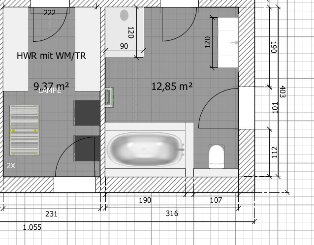

GrymHello,
we’re a bit stuck with the layout of our bathroom and wondered if you might have any ideas? Our plumber mentioned that meeting with him before obtaining the building permit/planning permission might not make much sense, hmm... :-(
Unfortunately, once the building permit/planning permission is approved, things like windows and load-bearing walls become fixed, and that’s exactly where we still have some flexibility. For example, the window could easily be placed anywhere along the short wall at the bottom since the utility room is located there, and that room could have a window practically anywhere. Alternatively, the window could stay roughly where it is but be moved a few centimeters (inches) here or there—however, it must remain symmetrical to the toilet on the opposite side one floor below, so moving the window closer to the door would not be preferred. It’s also possible to swap or shift walls with the adjacent utility room, create recesses, and so forth.

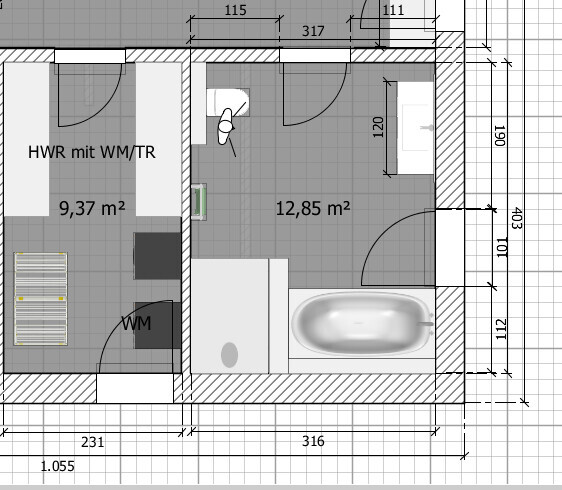

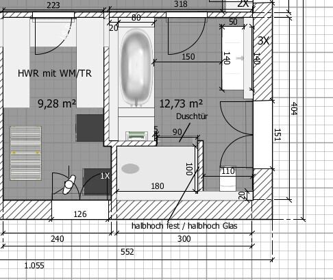

Here are four ideas from us:
Currently planned bathroom fixtures:
190 x 90 cm (75 x 35 inches) duo bathtub
at least 120 x 90 cm (47 x 35 inches) shower area (not tiled, something like Villeroy & Boch Squaro or similar)
120 cm (47 inches) wide washbasin (single faucet) with wide countertop surfaces on both sides included in the 120 cm
and one toilet
The window position most likely feasible is as shown in layout 1 at the top, regarding exterior symmetry and so on.

The sizes of the bathtub and washbasin have already been discussed in great detail between the two of us, and many options were tried out. These are now the results. Only for the shower is this more of an estimated value, which should probably be comfortable and spacious enough.
Can you redesign the window? Then I would place it on the other side and simply arrange the shower and bathtub or the sink and toilet on the left and right sides.
I highly recommend the Kaldewei Mega Duo 180x90cm (71x35 inches) with body shape – it also fits very well with a 90cm (35 inch) shower.
