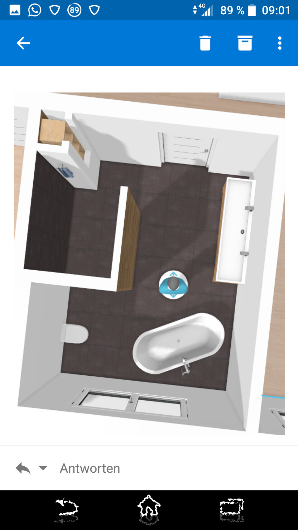

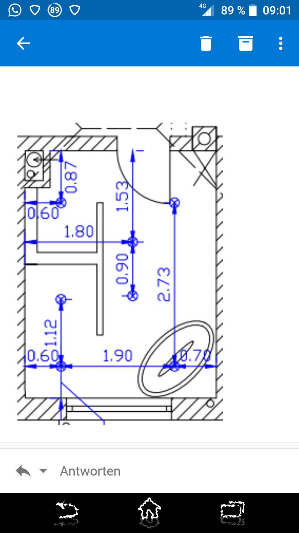

Grantlhaua11 Apr 2019 13:43Hello and sorry,
The upper image shows what I have planned now and what fits easily in terms of space (I sketched it out in the room). The room measures 4.13 x 3.20 meters (13.6 x 10.5 feet). The L-shaped element is now positioned 1 meter (3.3 feet) away from the top wall and has an internal dimension of 1.2 x 1.2 meters (3.9 x 3.9 feet). The planned washbasin measures 180 x 60 centimeters (71 x 24 inches), and the bathtub should, of course, be placed as far as possible into the corner. The built-in cabinet in the top left is intended to serve as a laundry chute. Here, I considered enclosing the chute up to the ceiling and integrating shelves for towels into this enclosure.
The lower image shows the current arrangement of the spotlights.

Grantlhaua11 Apr 2019 13:52The precast concrete ceiling with the corresponding Kaiser junction boxes is already installed. Unfortunately, we ordered the ceiling according to our own plan and therefore planned the recessed lights accordingly. The bathroom planner did not inform us about this either, so we only realized it during the shell construction phase.
