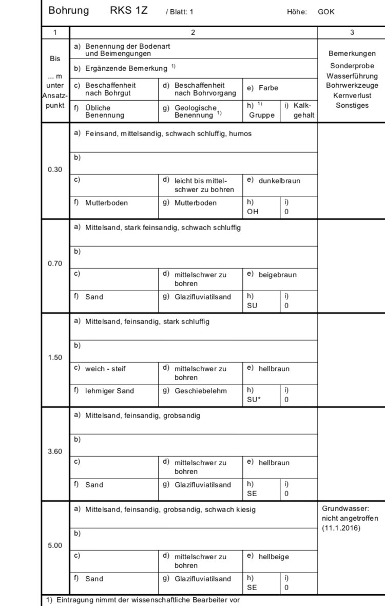

I have. I sent the survey report of the construction area to the civil engineer... A core drilling was carried out about 20 meters (65 feet) from my property. Here are the results
Borehole log with depth details, soil types and remarks – RKS 1Z

Does your earthworks contractor also cover the warranty without an expert report? We had to commission one; otherwise, they wouldn’t have done anything... Better have your contract reviewed again.
L
Lumpi_LE
3 Jun 2019 08:31
Building ground is the responsibility of the builder; without an expert report, later any damage can be attributed to the building ground.
Z
Zaba12
3 Jun 2019 08:55
As already mentioned, if you haven’t conducted a soil investigation on your property, your chances will be very, very poor if your house starts to settle. A geotechnical report done 20 meters (65 feet) away won’t carry any weight in court (if it comes to that).
Didn’t you know that a soil investigation is advisable? My shell construction contractor also didn’t want to do one! I didn’t care and had it done anyway. Better safe than sorry! After that, he couldn’t make any excuses.
Suddenly, the foundation was no longer built on gravel but on a clean concrete layer.
