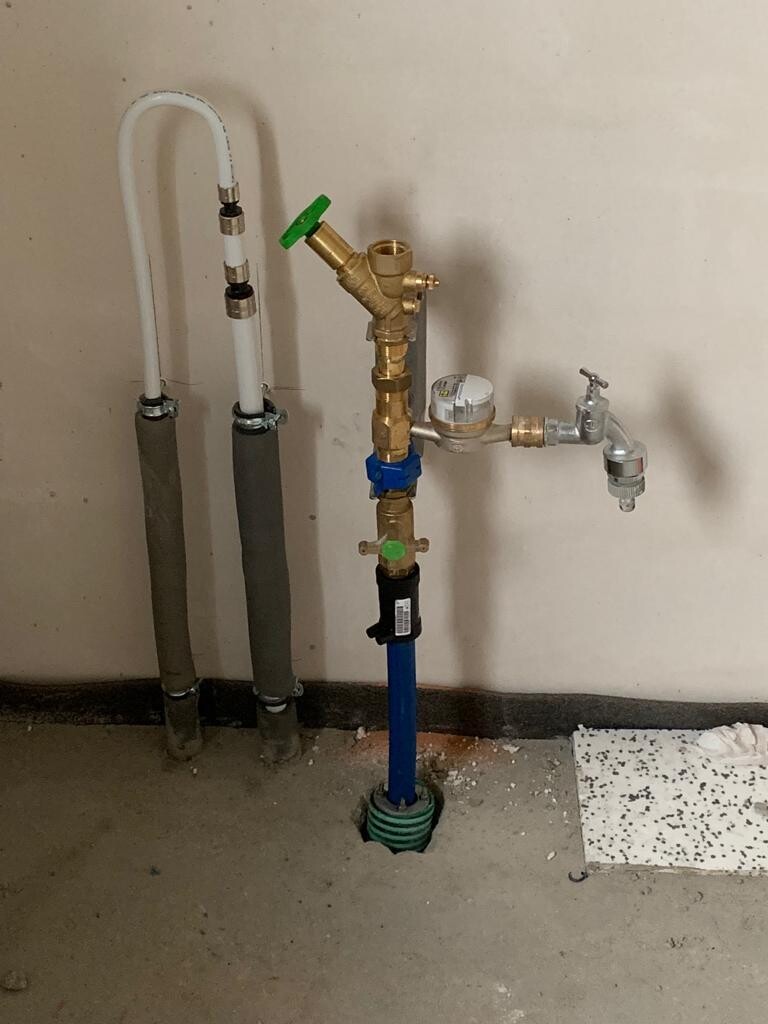

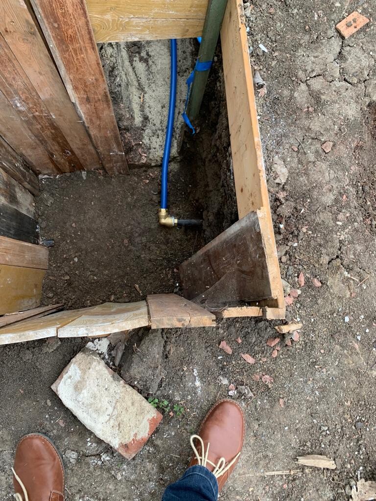

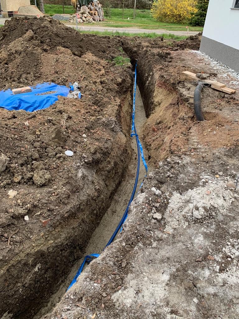

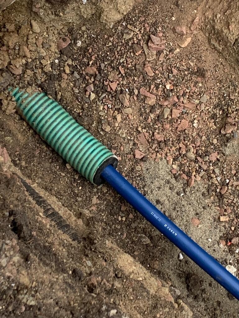

This is how it went for me. I contacted the responsible water supplier to check the situation before I started building. They provided me with a 2m (6.5 ft) long DN80 flexible pipe. The structural builder/excavator installed this into the foundation slab according to the water supplier’s specifications.
The new connection cost us about €1700, which includes a flat rate for 10m (33 ft). If you need more, it costs €100 per meter (3 ft) in the public area and €50 per meter (3 ft) in the private area. However, in the private area, you get a €20 credit per meter if you do your own trenching.
I rented a mini excavator because I had about 25m (82 ft) on my property and dug the pit myself to about 1.3m (4.3 ft) deep. Then the supplier’s service van came and laid the water pipe in the trench. One end was connected to the main line with a socket, and the other end was pushed into the house. At first, the construction water meter was connected again. The final meter will be installed only after the installation with the water filter is complete and the installer orders the meter from the supplier.
