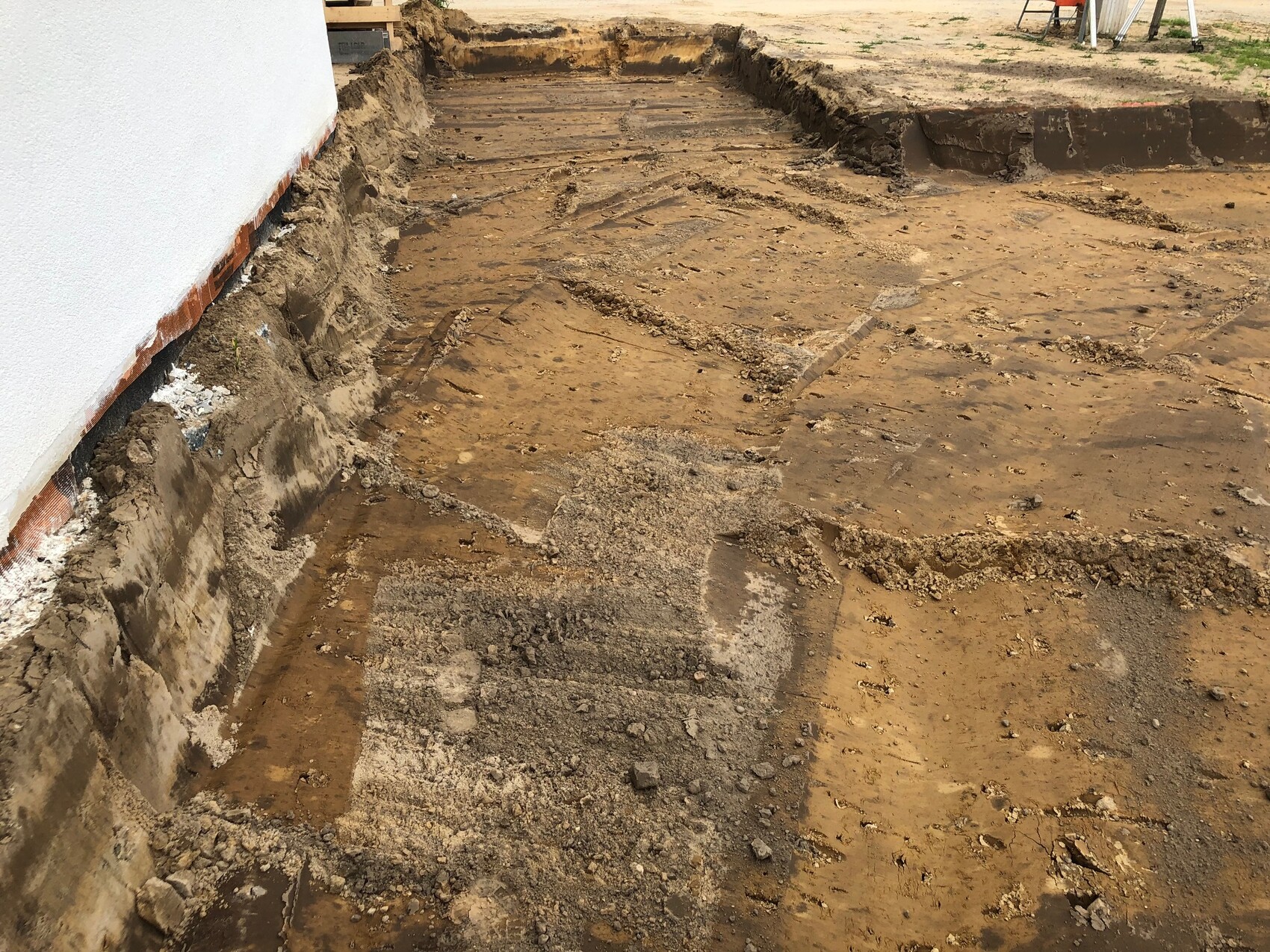

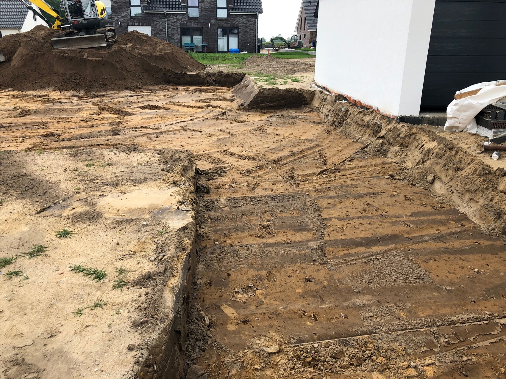

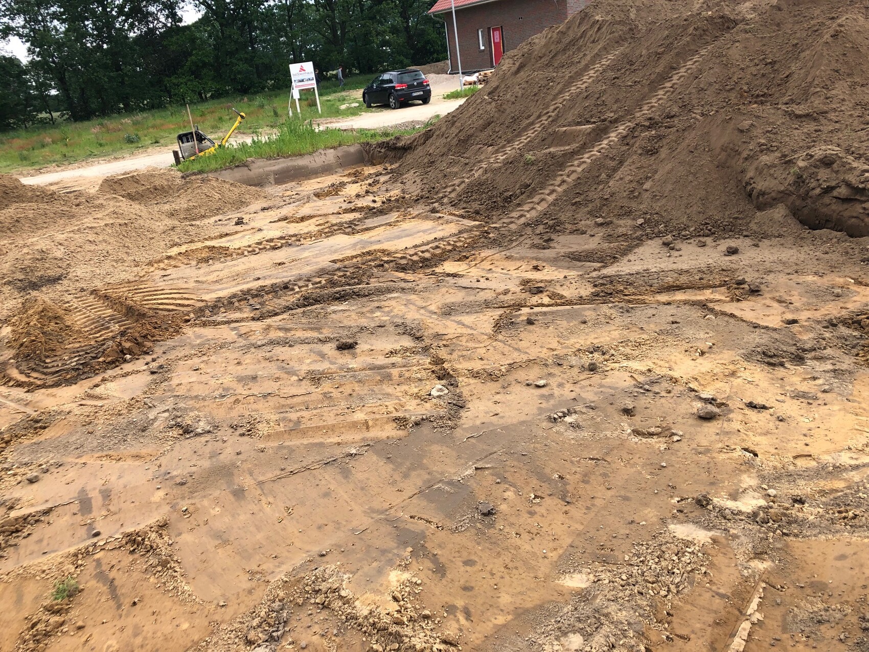

the groundwork for my house has begun. The excavator removed about half a meter (20 inches) of topsoil. After removing the topsoil, he concluded that the remaining soil is natural subsoil, which is very suitable for construction. Could you please share your assessment?
I would appreciate your feedback.

tomtom792 Jun 2019 19:48
The color looks like clay, so it should be suitable.

Thanks tomtom79 for your answer. Is clay soil considered load-bearing? Does it count as native soil?
Nordlys
2 Jun 2019 20:45
With an appropriate foundation using sand and gravel, clay is suitable for building.
Chrichie
2 Jun 2019 20:49
Have you had a soil survey conducted?
wrobel2 Jun 2019 21:38
Hello
the civil engineering contractor will certainly be correct on that.
