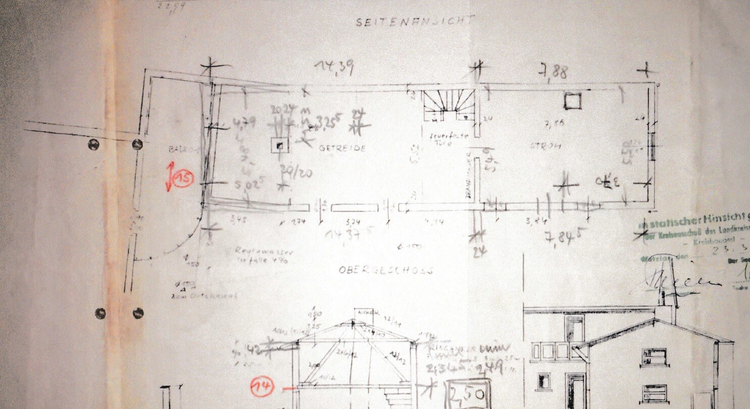

How large is the barn? Are there any plans for it, or did the architect first have to do a survey of the existing structure?
As I said, I only know my own time investment; I’m not really involved in construction drawings, but that seems reasonable and completely fair to me.
Yes, the original construction drawings and the structural calculations do exist — it definitely makes sense to review and, if necessary, update them afterward. This is also a separate item in the fee proposal.
I also think this can’t really be compared to my hobby-level software — which is why I already included a factor of 4. But three days of work just seems too long to me, and I honestly can’t imagine what could fill three full days.
Roughly simplified: draw five walls (north, east, south, west, and one wall that separates the two rooms; one wall has a bend), add an opening between room 1 and room 2, draw two windows, two doors, a staircase from below, and the roof with exposed rafters and an x-degree pitch — set the room height at the wall and enter the maximum height at the highest point of the roof (if it’s not directly calculated from the pitch). That completes the current state. For the planned state, add an opening for a second door, extend the windows to floor height, and convert the two doors into windows. Change the fiber cement roof into a properly covered and insulated roof. That’s it. And that takes three days? Plus an extra day for the architect?
As I said, it really doesn’t seem to me that the architect is trying to overcharge. If you look at it from another perspective:
24 hours minus a 50% buffer leaves 16 hours. Just considering that a layout has to be created, everything properly labeled and prepared, the work involved in the plan’s format alone takes about 2 to 4 hours. So that leaves around 12 hours for the actual drawing.
If the architect is not yet working in 3D (which is not uncommon), they have to create the views and sections separately and cannot simply generate them as a “byproduct” of the floor plans.
If you add everything up roughly, you could even say that 16 to 20 hours might be possible if you’re being very exact. However, this can’t really be judged because there is also the structural engineering calculation happening during the lead time.
If I were you, I would just politely ask him to explain the time involved and what exactly is included in it. 😉
