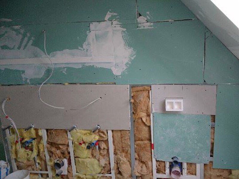

And to lighten the mood, here’s a small example
I’d bet that the main contractor will only hand over the execution plan once the building is already up.
They will ask you what and where everything should be installed (sanitary fixtures, piping, heating, etc.) and how the windows and doors should open, then they will work based on their existing experience.
For office workers retrained as tradespeople, an execution plan won’t help you either.
I think you just have the wrong idea about construction.
