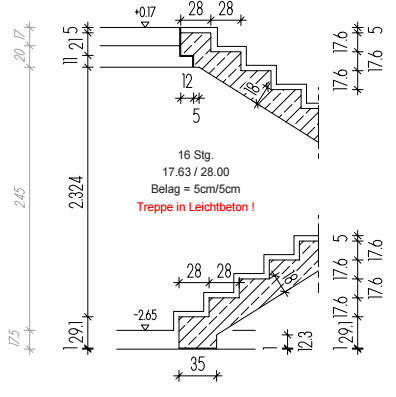

Hello "bluminger".
Since the natural stone slabs are fixed directly onto the load-bearing substrate (the treads and risers of the concrete staircase) with cement mortar, the thickness of the material is actually of minor importance. A thickness of 50mm (2 inches) is certainly more than sufficient; at that thickness, the slabs would even be self-supporting! Theoretically, tiles as thin as 10mm (0.4 inches) would also serve the purpose here, if you want to consider the material thickness at this point.

5cm (2 inches) natural stone as a covering?
Common thicknesses for natural stone are:
Window sills: 2-3cm (1 inch - inside usually 2cm (0.8 inch), outside usually 3cm (1.2 inches))
Kitchen countertop: 3-4cm (1.2 - 1.6 inches) (smaller ones 3cm (1.2 inches), larger ones 4cm (1.6 inches) plus number and size of openings)
Cantilevered natural stone stairs and possibly landings: 6cm (2.4 inches) (3+3 glued layers)
