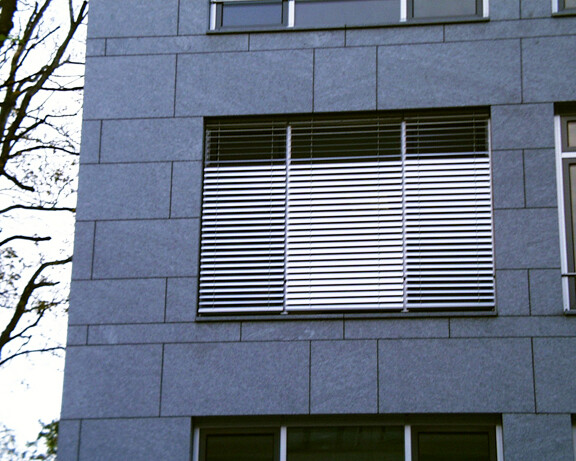

Painkiller7 Jun 2016 09:58You said the window faces northwest, so shading isn’t the main issue but rather privacy. Since blinds have the advantage that you can hardly see in but can still look out reasonably well when they are slightly tilted, I would say it doesn’t really matter whether you can tilt the top and bottom sections separately, because you will probably keep both at about the same angle anyway.
With a single blind, you also have the option to lower only part of it, allowing you to control the shading.
With two separate blinds, you have to operate two controls, and in the end, the top and bottom probably won’t be tilted the same way (purely aesthetic, but I find it nicer when it’s even).
At our company, for example, we use two divided blinds, which allows excellent control of both shading and privacy.
