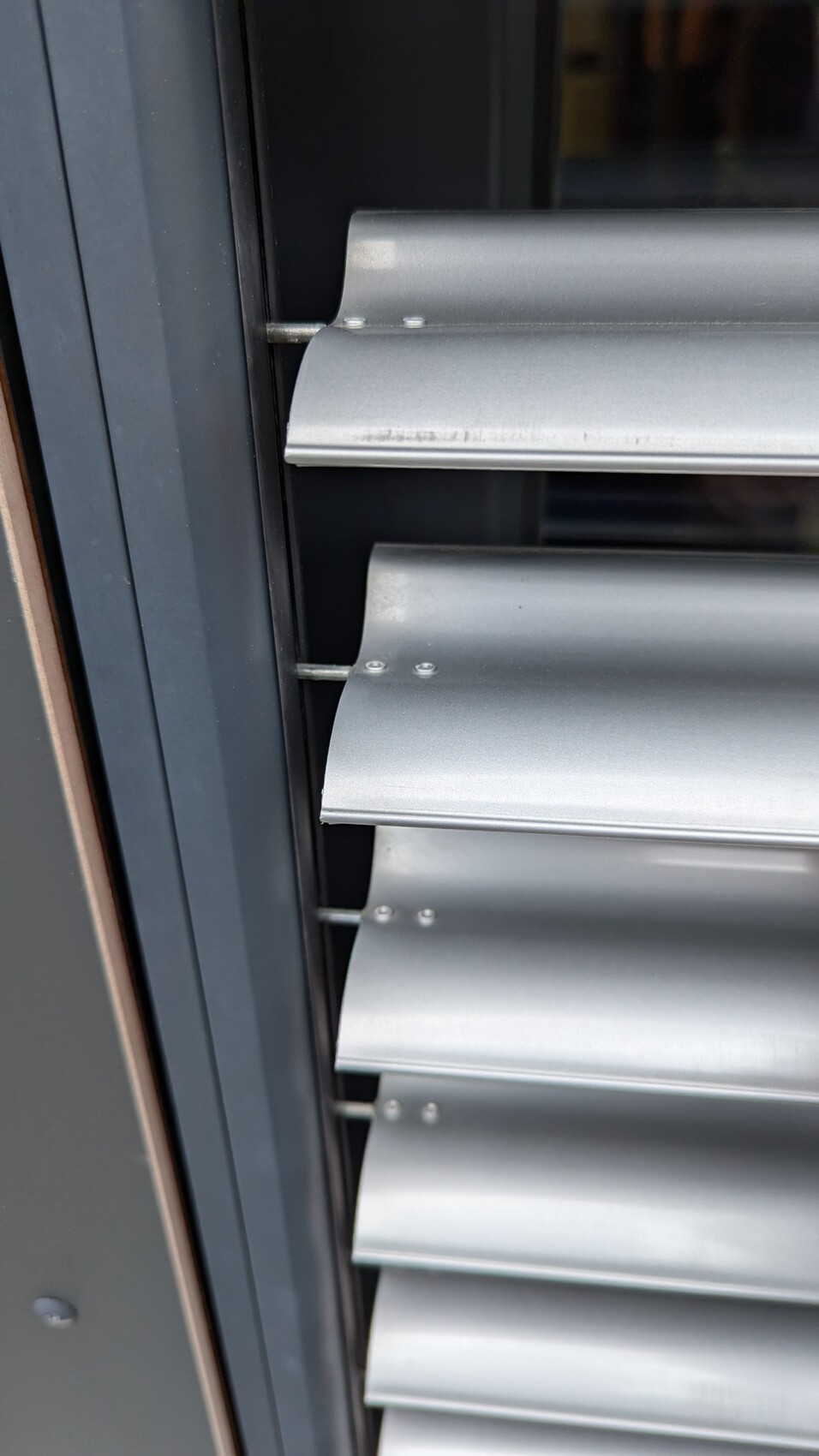

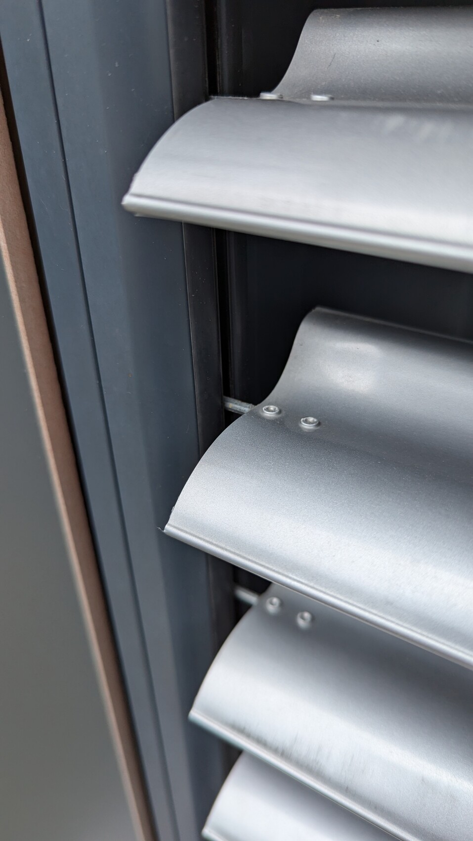

We recently visited the display home exhibition in Munich Poing and saw these blinds / external venetian blinds on a Regnauer house.
Unfortunately, the house was not open, and so far the manufacturer has not replied to my email.
We saw blinds there that looked very sturdy and wind-resistant. The slats were made of fairly thick material.
Does anyone here know the manufacturer of these blinds?
Thanks for your help

These are Roma three-arched slats. There are now also Roma slats that are more stable and provide better shading (Comfort & Design Slat CDL). Warema also offers comparable slats.

Such S-shaped slats are available from many manufacturers.
As mentioned before, there are also Z-shaped slats that allow slightly more light to pass through when open while still providing excellent darkness when closed. Some even come with rubber seals. It is also important to pay attention to the rails.
