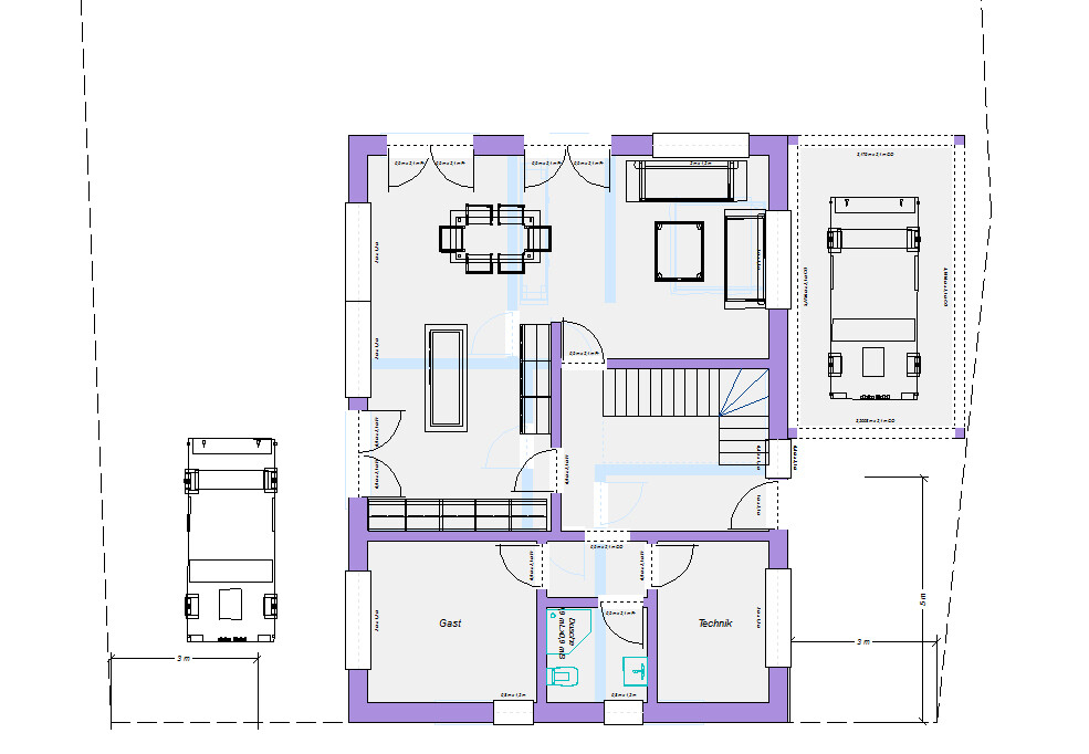

The question is whether any alternative building method justifies a legal dispute. Here, I see a rather simple gable-ended building approximately 9m x 12m (30ft x 40ft). To the right, there is a carport and a parking space on the left side of the plan. Quickly sketched without any claim to originality:

The question is whether any kind of alternative construction method would justify a legal dispute. From what I can see, this is a rather straightforward gabled building of about 9m x 12m (30ft x 39ft). To the right is a carport and a parking space on the left side of the plan. Quickly sketched without any claim to originality:

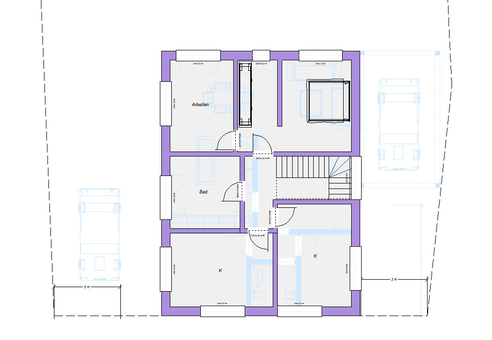

[ATTACH alt="grundriss-175qm-satteldach-ohne-keller-620336-2.jpg"]78541[/ATTACH] [ATTACH alt="grundriss-175qm-satteldach-ohne-keller-620336-1.jpg"]78540[/ATTACH] Oh wow! Thank you so much for your time and effort. We will go through this here.A legal dispute is not an option for us. With the current interest rate situation, we simply don’t have the time for a court case. As I said, right now we’re more wondering if there are solid reasons to dismiss the architect?

Well, one could argue that the garage in the design is not likely to receive planning permission (building permit). That’s quite a significant oversight. If you insist that relocating it with this floor plan is unacceptable and take a firm stance, I could imagine that you might agree on a financial settlement to resolve the issue. On the other hand, the architect, like any market participant, has the right to make corrections. Perhaps the argument about the distance from the construction site and the considerable loss of trust could also help your case. If it really comes down to it, you could even threaten to expose the “shame” publicly. Well, however, it’s unlikely to be resolved without losses. What exactly did you sign?
