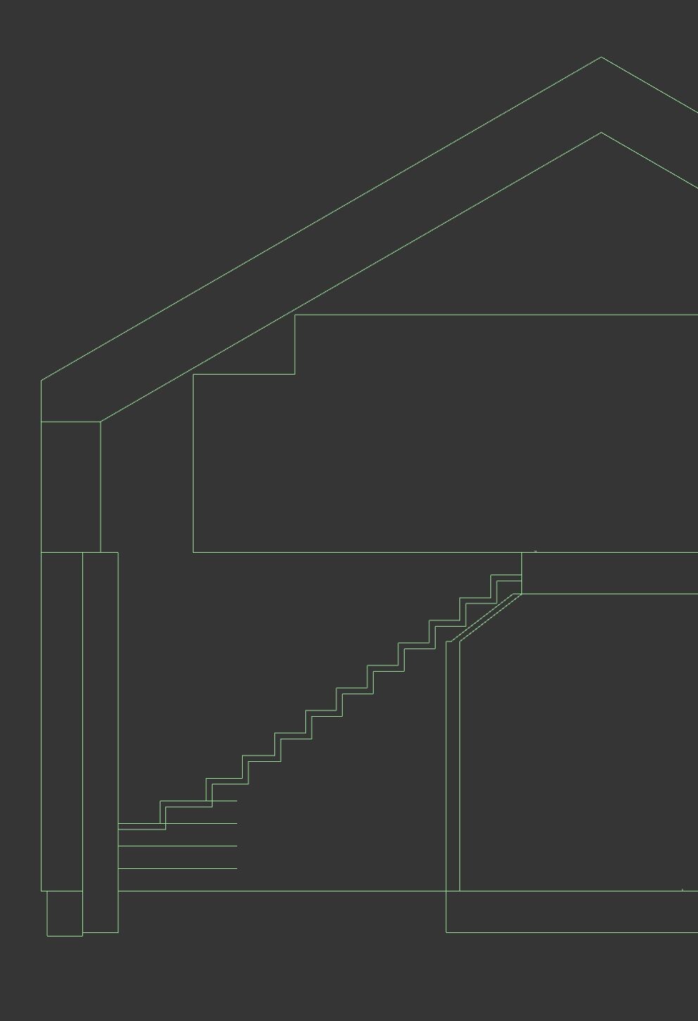

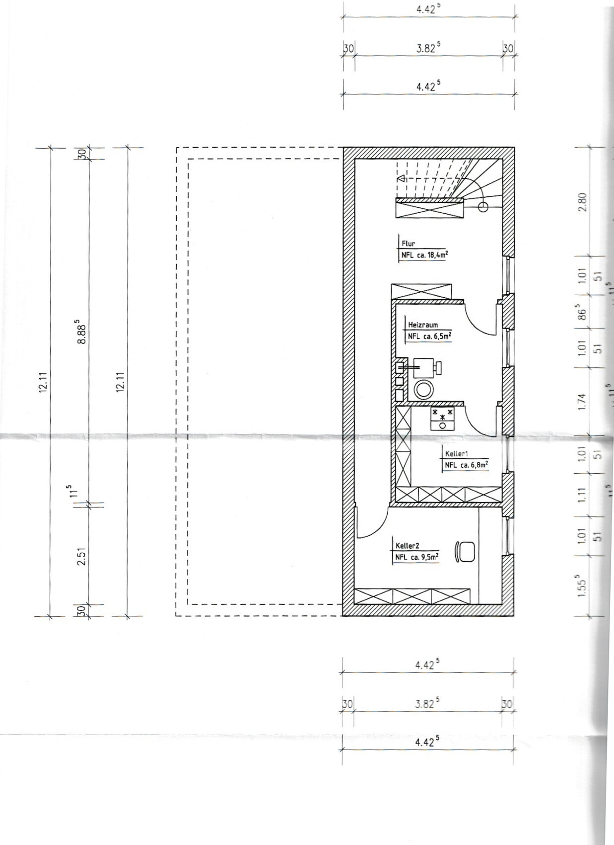

The ground floor slab will be insulated and fitted with underfloor heating. The basement stairs will be extended by one step, allowing about 25 cm (10 inches) of height for this.

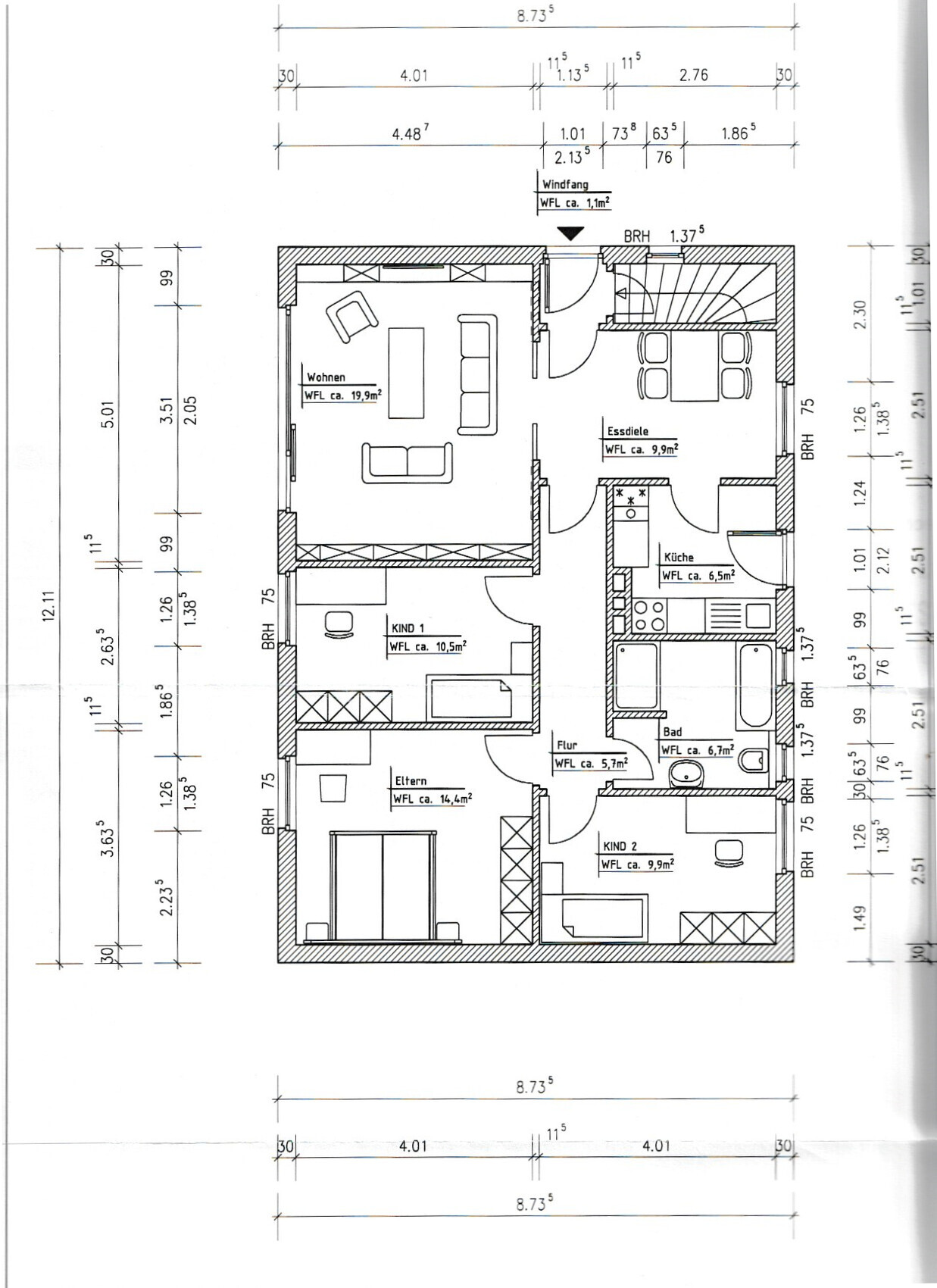

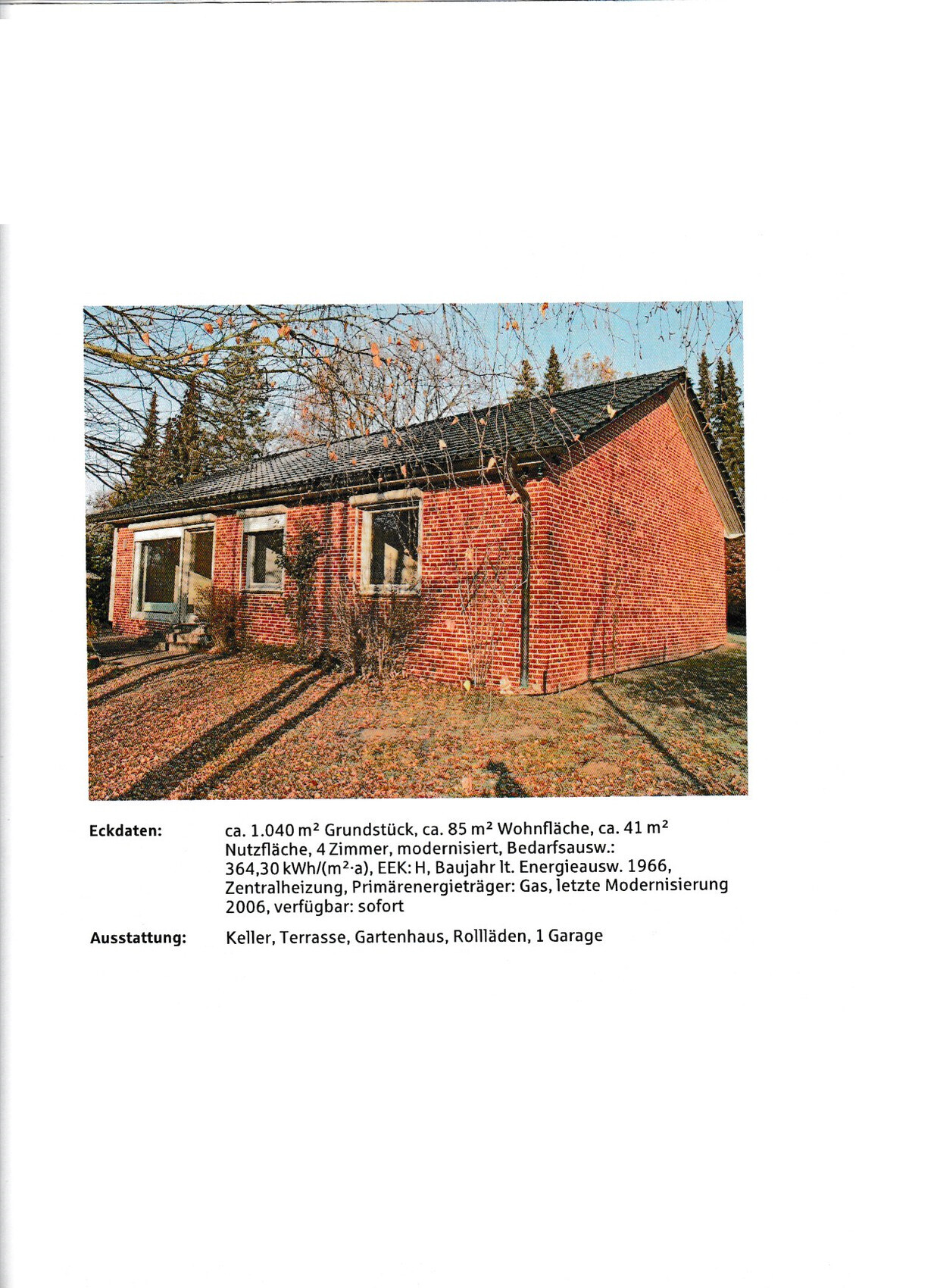

I agree with the suggestion to share the existing plans and photos of the house as well as create overview plans, and I suspect it might be a bungalow. Extending the design with the basement stairs located in the corner is a serious disadvantage for the floor plan. With accurate data about the existing structure, more convincing solutions can be found. Economically, this kind of “renovation” would be a costly Pyrrhic victory ;-)

Are there pictures and plans of the existing building?
I’ve attached a sketch of the staircase. It should work. There would be room for one more step.
hanghaus2023 schrieb:
If you’re already planning yourself, then please do it properly. Demolition is shown with yellow dashes, new build in red, and existing original parts in black.
I know, it was just for me. But I thought it might still be helpful.
