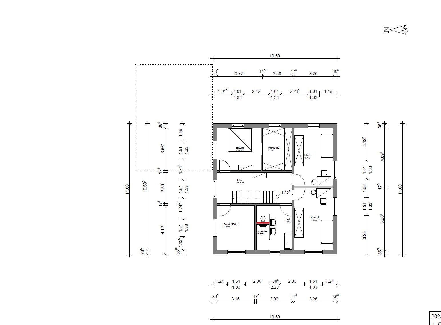

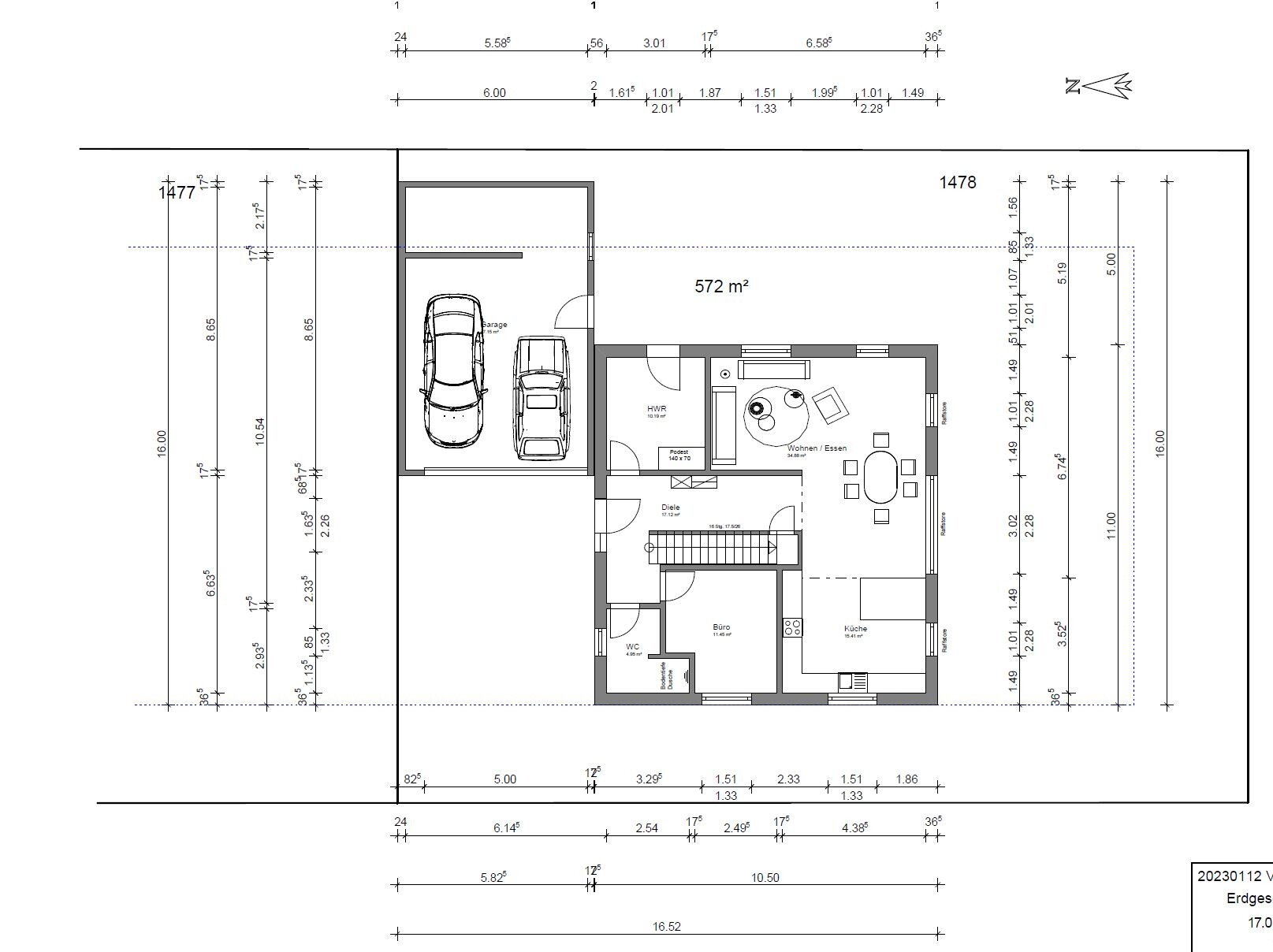

We have received our preliminary design. Overall, we like it. Except for the sofa corner, which is probably a bit too small – but the kitchen area is huge. That’s why we will swap the kitchen with the living area.
Also, for now, we have planned without the cantilevered upper floor above the entrance area (great idea from ypg) and only with a canopy, which is not yet shown on the design. According to the general contractor, the bay window would cost about 11,000 Euro more (7m (23 ft) wide, 1m (3 ft) deep).
What major flaws do you notice?
Grundriss eines Hauses mit Garage, Eingang, Küche, Wohnzimmer und Büro im Erdgeschoss
Grundriss eines Wohnhauses: Obergeschoss mit Flur, Eltern-, Ankleide-, Kinder- und Gästezimmer, Bad.
