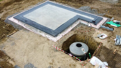

The excavation was significant. But fortunately, we were still able to reuse our soil well on the property.Yes, the holes are huge. Here is a photo of my hole compared to the foundation slab. The cistern has a volume of 8 cubic meters (10.5 cubic yards).TmMike_2 schrieb:

Yes, the holes are huge. Here is a picture of my hole compared to the foundation slab. The cistern has a capacity of 8 cubic meters (10.5 cubic yards).
