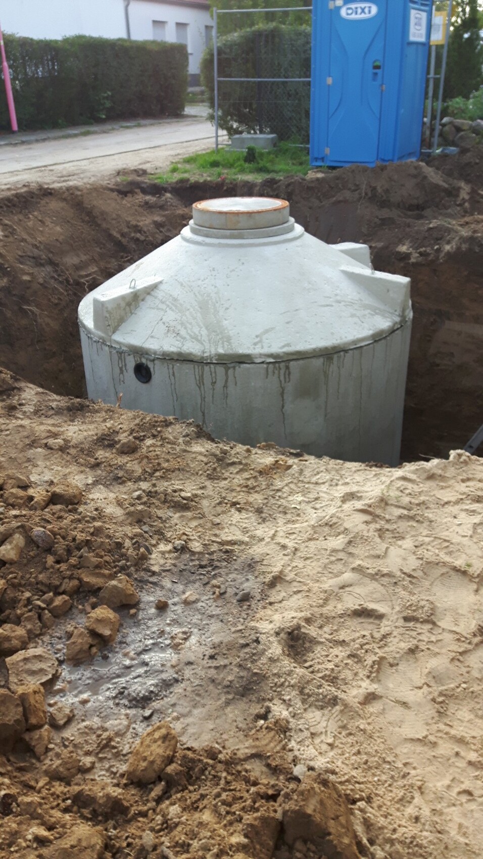

I have also connected all downspouts and my air source heat pump to a cistern with a capacity of 8 m³ (8,000 liters). This works very well for us during the summer months. When the cistern is full, the excess water is drained into an underground soakaway. I would definitely do this again. I installed a concrete cistern. It is supplied by a Berlin-based wastewater technology company.
