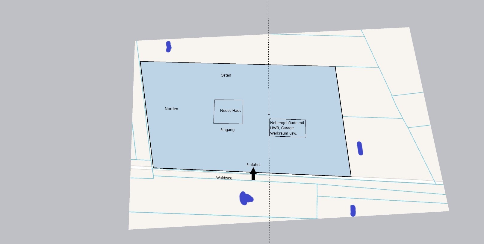

I will add the site plan shortly.

Where is north? Maybe include a site plan with the garage, etc.
Could you please elaborate on your concerns about the bathroom/toilet?

haydee schrieb:The site plan is coming.
Please include the site plan.
Where is north?
What is the budget?
I assume the plot is not in Germany.
