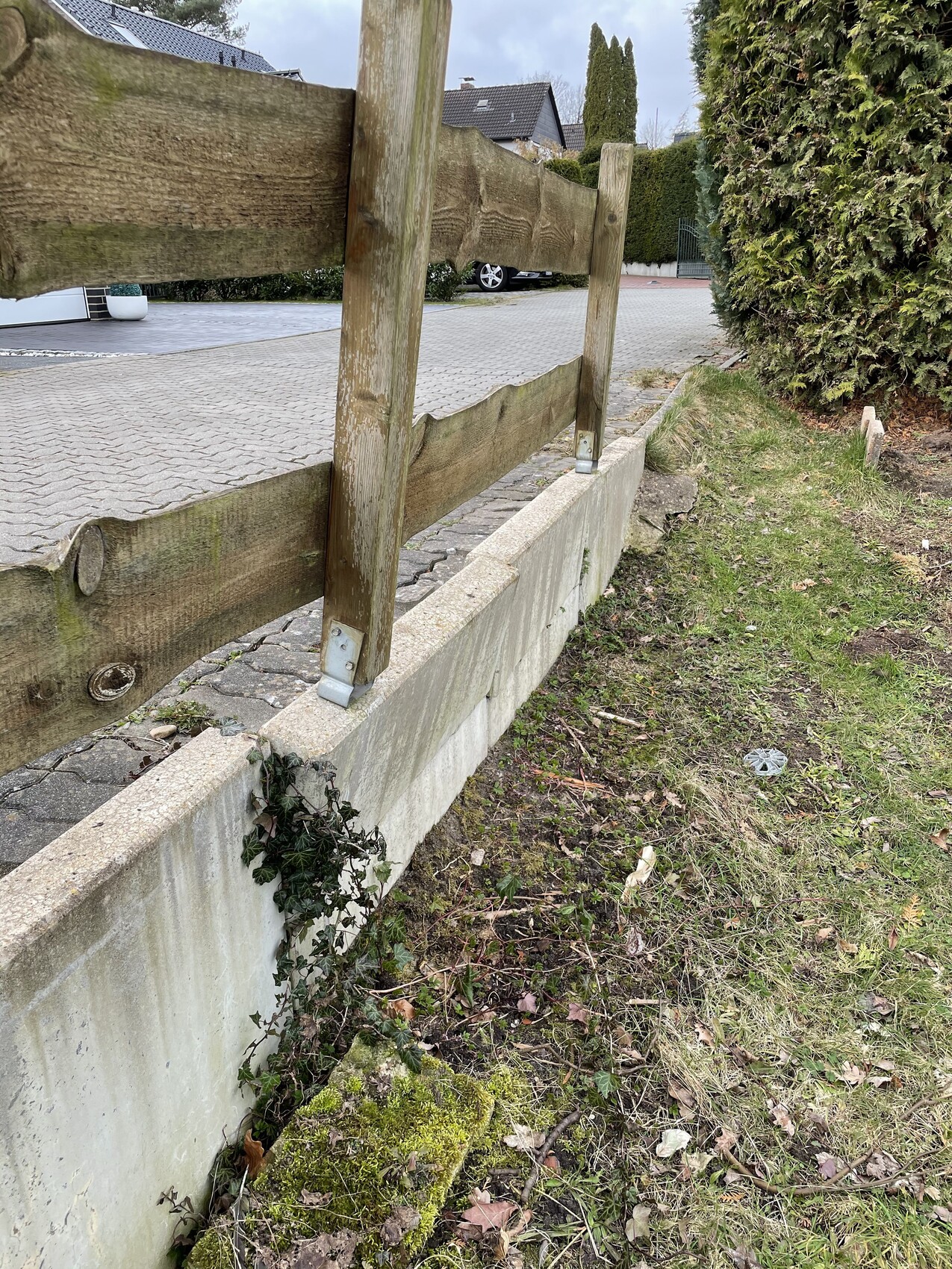

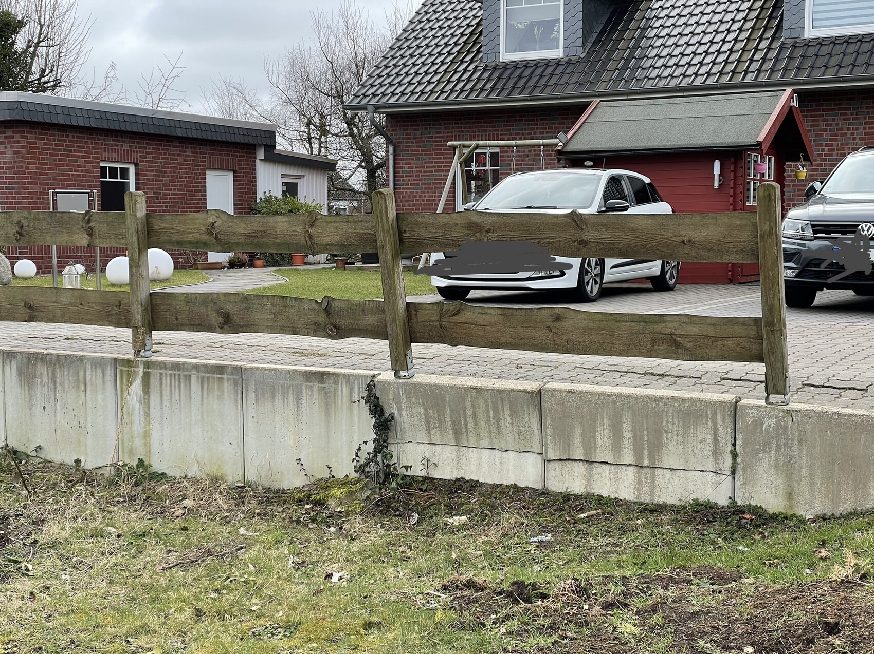

The retaining wall is right on the edge of my property, separating the private driveway from my land.
They will be adding fill there, that’s true.
Two stones in the wall are affected; they have been leaning for some time, but today I noticed they are cracked in the middle 🙄
The general contractor responded regarding the 5 meters that they will check what alternatives are available or how it can be resolved and will get back in the next few days..

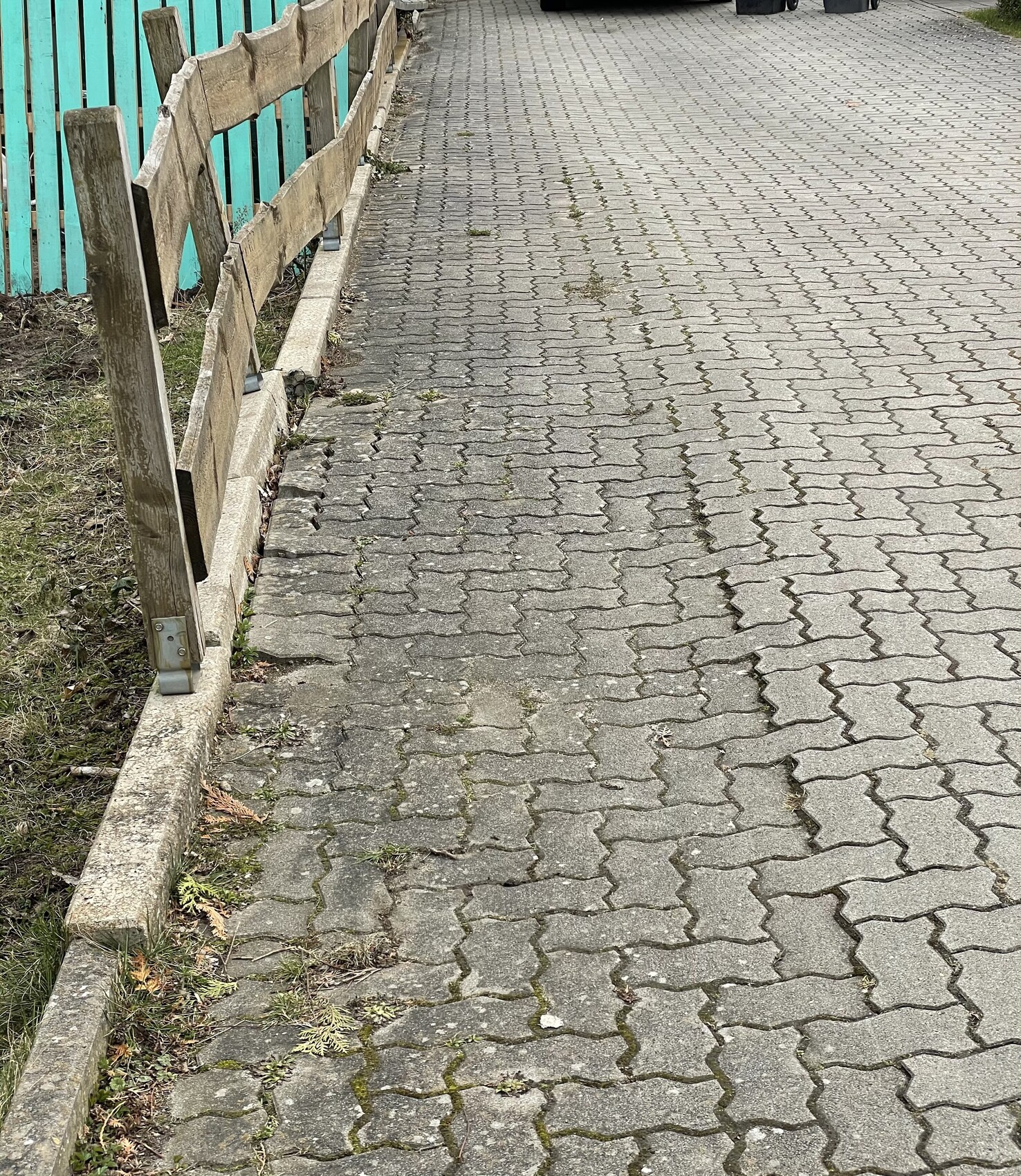

I have now taken some photos.
The lowered paving stones belong to the private access road, and even if I partially fill up the plot in the corner, it won’t reach all the way to the top.
Can I now inform the residents in the second row that this area is sinking (they can see it too)?
Is there anything I can do about it?
Thank you very much for the photos.
You already have evidence secured. It is clear that the shoring has already failed. So, you are not responsible when you start building.
The owners of the road should wait with the renovation until you have finished building. The shoring with L-shaped blocks is insufficient.
It is important for you not to excavate in that area. An underpinning would be necessary there.
Basically, I would say that the break points do not look like material fatigue.
To me, it seems more likely that the cause of the break was a “user error.”
It is precisely the two pieces where the fence is mounted that have broken.
Nevertheless, you have now sufficiently secured the evidence and documented it.

Basically, I would say that the fractures do not look like material fatigue.
To me, it rather appears that the cause of the break was a "user error." No, it is neither material fatigue nor a "user error," but a design or dimensioning flaw.
