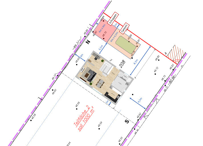

Dear forum members,
We bought a plot of land last autumn and are currently deep into the floor plan design. We would like to share our current draft with you and welcome any comments and opinions.
[F]irst some preliminary information about the plot and its buildability:[/F]
  • 1000 m² (10,764 sq ft) rear plot, southwest facing (so southwest is on the left side of the site plan)
  • Building boundary up to approx. 16 m (52 ft) behind the property line (up to the dashed line on the site plan)
  • No zoning plan (construction according to § 34 of the Building Code)
  • Groundwater at surface level and peaty soil (exact geotechnical report pending), so piled foundation required and no basement
Our requirements were and still are:
  • Affordable! (Our maximum budget for the house including foundation slab is €230,000)
  • Country house style
  • Bright, large windows facing south/garden
  • Open living/dining/kitchen area
  • Family of four, 1 bedroom and 2 children’s rooms
  • Not oversized, max 150 m² (1,615 sq ft), preferably less
House design:
  • Solid construction using Ytong blocks (for us the most cost-effective option, although we would have liked to build with wood as well).
  • Developed ourselves after studying various floor plans (including from the book "Affordable Building with a Small Budget" by Achim Linhardt) with support from architect friends and our planner (an independent civil engineer).
  • Dimensions 12.50 x 7.50 m (41 x 25 ft) (the measurements shown on the site plan are from an earlier draft).
  • What we like: open living area, all main rooms have large windows facing the garden, efficient size, although the children’s and bedroom could be smaller, sewing/work nook behind the stairs upstairs, plenty of wall space for large wardrobes in the upstairs bedroom and hallway on the ground floor, light shaft in the stairwell, staircase (we originally wanted a straight run staircase but it would have taken too much space; the one with three quarter turns is also fine with us).
  • What we don’t like 100% yet: the height of the house from the outside. It is currently planned as a two-story house with an eaves height of 6.2 m (20 ft), with the ground floor 2.84 m (9 ft 4 in) high and the upper floor 2.60 m (8 ft 6 in) high. The gable roof will be an uninsulated, unfinished cold roof, mainly because of the economical prefabricated truss construction method. This is a bit disappointing because I really like sloped ceilings and did not want the character of a townhouse. Lowering the roof with a knee wall of about 1.90 m (6 ft 3 in) and an insulated roof with open sloped ceilings would probably be more expensive due to the rafter/beam construction. We would also lose the garden view through the floor-to-ceiling bedroom windows.
Now for our questions:
  • Simple: What do you think about the floor plan?
  • Can you still imagine the relatively tall two-story house having a country house character? Maybe it depends on the facade design and choice of materials? Do you think it looks too “blocky,” especially from the front entrance side? Or would a lower eaves height with an attic conversion including a knee wall be preferable?
  • We are still unsure how to arrange the windows on the garden side. The drawing with the elevations shows two possible versions. We actually prefer it when the upper floor window is centered over the lower window front. However, this does not align the interior line of sight from the entrance door to the garden/patio door (see ground floor plan). This represents version two; for version one, the window front would have to be shifted about one window width to the right, so that the patio door is behind the dining table. With the window front shifted left, the interior looks better to us, but from the outside it looks strange if it is offset from the upper floor window, right? What do you think?
That’s it for now regarding our project. We really look forward to all your opinions!

la.schnute11 Mar 2020 12:30
By the way, here is the sun path orientation again... around 9:00 a.m. on weekends in March, the sun shines directly through the kitchen window, which I actually find quite nice.

11ant11 Mar 2020 12:36
la.schnute schrieb:
The morning sun is only really important at breakfast time (to somehow get going)
Then an infrared heater at the breakfast area was suggested to you, otherwise in the wet, cold, and gray German winter, you just won’t get moving.
kaho674 schrieb:
Mixing both doesn’t seem to work
You can mix nitro and glycerin too, but then you better not mind the bang.
Mixing acids and bases would be pointless.
kaho67411 Mar 2020 12:54
la.schnute schrieb:
And no, I really don’t understand why reversing the orientation would make more sense. Instead of sarcastic remarks, a real explanation would be appreciated.
As if that wasn’t enough.
Your single south-facing window won’t be able to light the 11m (36 ft) deep room behind it. So you’ll be sitting in the dark both at breakfast and at lunch. The sun only slowly reaches the living area in the afternoon – but in winter it’s already setting by then. That’s why it will be a gloomy situation.
Since you don’t have the budget for a large corner window solution in the kitchen, the most practical approach is to place the main living areas on the sunny side of the house and move the utility room to where it belongs: the north.
11ant11 Mar 2020 13:17
I compared the site plan from post #205 with the sun path and hope that my following assumption is correct:
Floor plan of a plot with an interior view of an open living area (living room/kitchen).
Nordlys
11 Mar 2020 13:22
In my opinion, the lighting in the room will be sufficient. There are windows facing southeast and southwest. There is no large overhang that would cause shading.
Ibdk1411 Mar 2020 13:30
Yes, if what the elephant put together is correct, I also believe that the lighting is sufficient. So my assumption that the house would need to be rotated was wrong.
