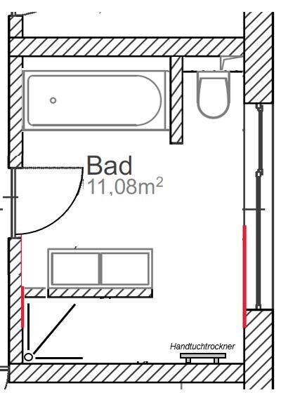

We are planning to start building our house in April, and just now realized that our bathroom layout isn’t quite working as expected. Specifically, we had planned an open shower with a T-shape design, but we’ve noticed that as drawn, it could lead to quite a lot of water splashing outside the shower area.
The open shower is planned with a depth of 80 cm (31.5 inches), which does allow quite a bit of water to splash out. A temporary solution would be to install a sliding door for the shower to close off the hallway.
Does anyone have ideas on how to design this with an open shower, a separate toilet area, and a double vanity? The bathroom door can still be repositioned.
Here is the current floor plan:
Thanks in advance for your help!

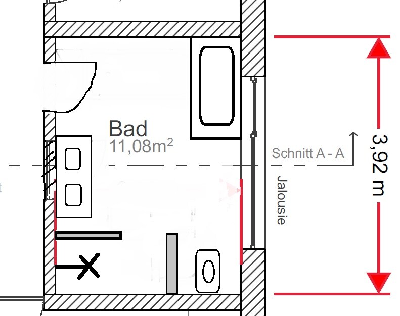

j.bautsch13 Mar 2019 08:21mottenhausen has uploaded two plans, which one do you prefer?
Please not the one with the washbasin facing away from the window? (I already explained why that’s not a good idea 😉 )
This one is much better! I would only make the shower wall as long as possible (the exit from the shower should be at least 85cm (33 inches), I think) and move the washbasin a bit further away from the door, or shift the door closer to the bathtub.
((andreas))14 Mar 2019 11:49It will be the second one. I just need to figure out how to manage the laundry chute (shown in the illustration within the prefab element).
We would raise the door slightly so that it maintains a 10–15 cm (4–6 inches) gap from the bathtub.

j.bautsch14 Mar 2019 12:51from above with a third variant as well (front wall only for the toilet)
