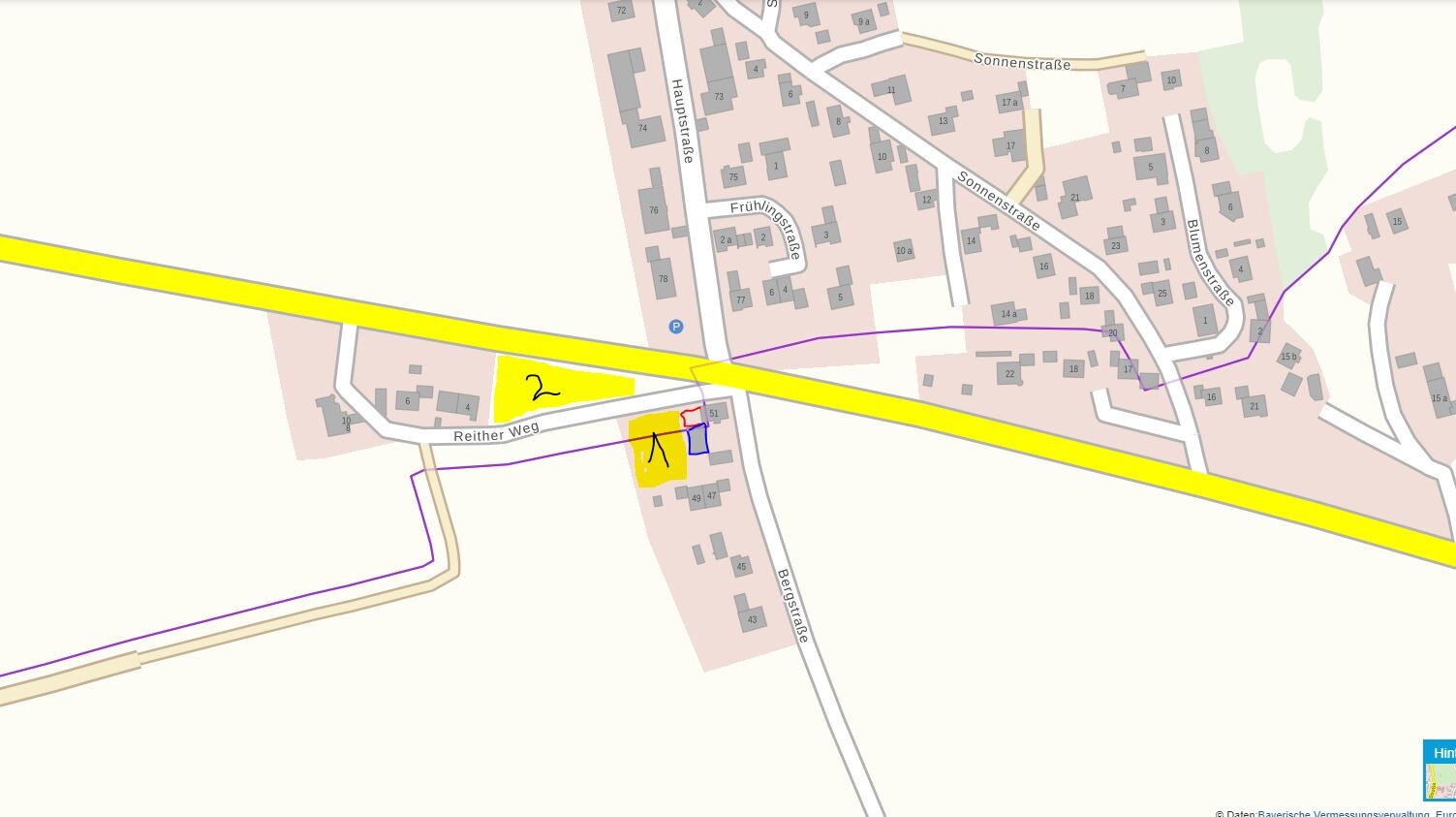

HausbauD
5 Oct 2018 12:26
The construction itself will not be cheaper; in the case of the barn, it might even be more expensive. However, the costs for the plot of land or possibly part of the development costs can be avoided (since I already own the land, nothing needs to be purchased).
The house is fully serviced. I am not sure whether the barn can be simply connected or if it needs new connections (with full costs like a new build).

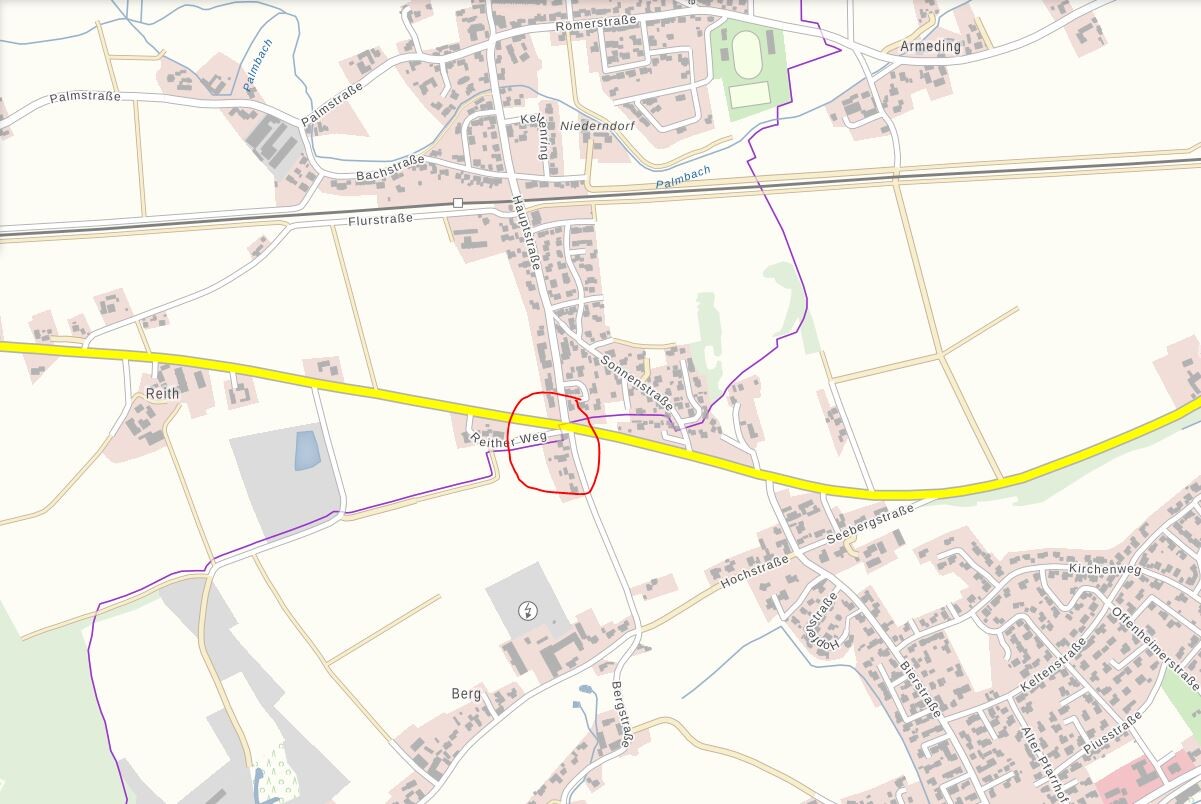

I have a plan from BayernAtlas—is that sufficient? Otherwise, I can take a photo of the regular plan, but in my opinion, it contains less information. I marked the two possible plots in yellow (1 and 2), with 1 clearly preferred and 2 already in the neighboring municipality. The extension is marked in red and the barn in blue.
Lageplan mit gelb markierter Hauptstraße, Grundstücksgrenzen und Gebäuden am Rand
Kartenansicht eines Dorfes mit gelber Hauptstraße, roter Markierung an einer Kreuzung
nordanney
5 Oct 2018 12:53
Judging by the pictures, it looks like an outdoor area. In your municipality, there is likely no zoning plan or specific regulation for outdoor areas in this location.
Try calling Siegfried at the building authority. Extension -21, and just ask him.
You won’t get better advice here at this stage.
P.S. The barn and the new building will probably need a standard internal connection, just like any other house. You’re only saving on the land.
