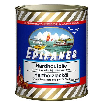

5) We’ll oil it with Epifanes hardwood varnish oil. Buy that. It’s available online and in stores, but only those near the coast.
6) After oiling long enough to achieve a closed, slightly glossy surface, we will have a result that only requires maintenance and touch-ups for the following years. Once the base is in, no more problems.

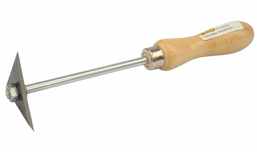

Nordlys schrieb:
Here are two photos. The oil and the triangular scraper.
Hi, thanks a lot in advance. I had already seen your recommendation about the oil in the search. Since it is neutral, I would just need to lightly sand the bare spots, right? Or do you mean to remove everything down to the raw material? That would be quite intense with so many windows.
