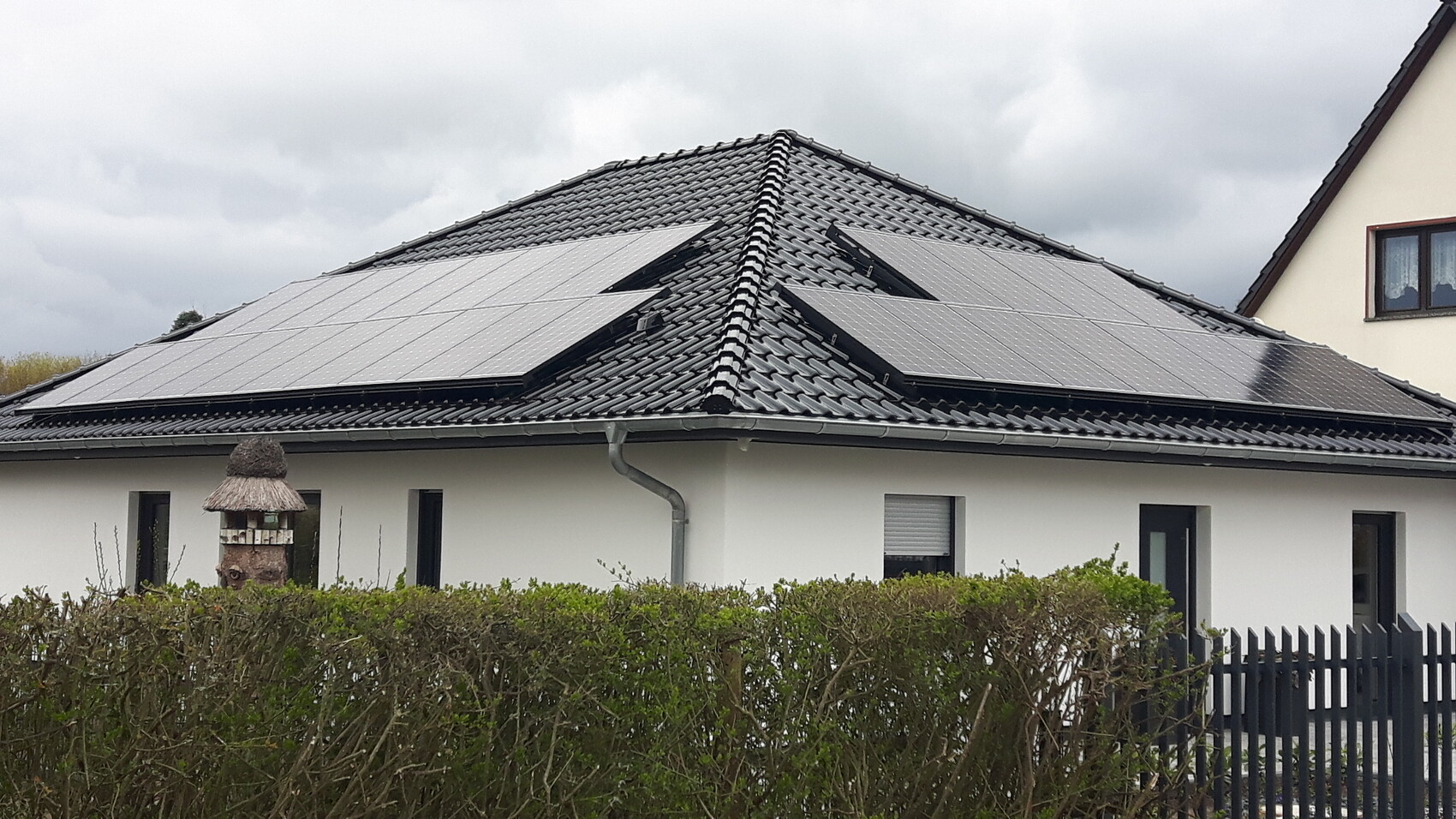

So, I installed two rows stacked on top of each other in three different directions. If a module in the upper row is defective, the module below can be removed to take it out. Of course, this always depends on the roof design and height. Since we have a bungalow, it’s quite easy and convenient with a better ladder.
hampshire21 Sep 2021 16:08Mahri23 schrieb:
So, I installed two rows on top of each other in three different cardinal directions.This description creates an image in my mind that doesn’t make sense. Please help me understand – maybe with a photo.Similar topics
