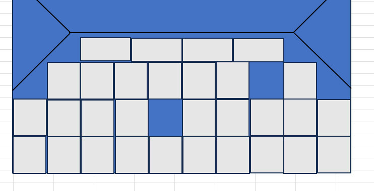

hanghaus202320 Apr 2025 13:19I placed my modules on the roof and roughly estimated its dimensions. The antenna and the small window don’t make sense on a photovoltaic roof.
You can even fit 30 modules there.
